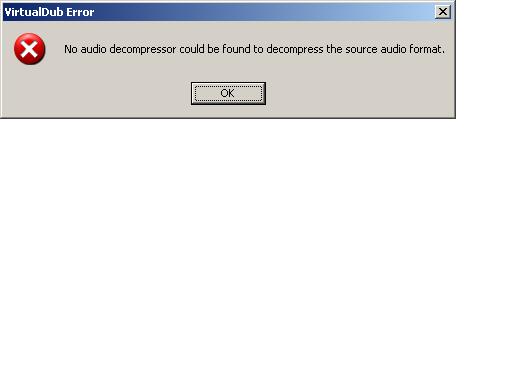

Thanks. Finally I found it, but while clicking Save as file and trying to save it with the new sample rate, it prompts for this error message.
Why?
(I'm using Panasonic DV decoder)

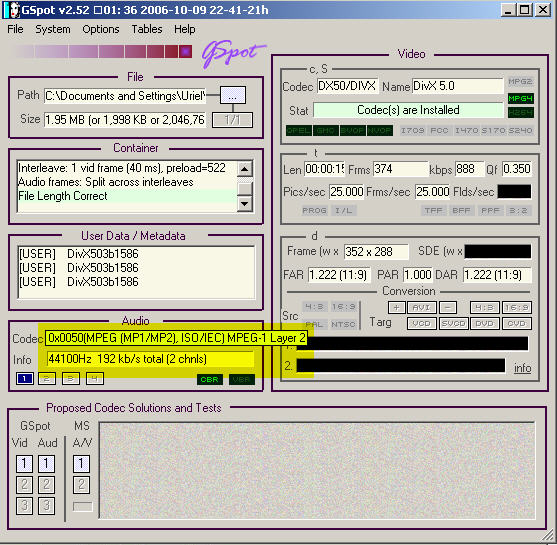

virtualdubmod should support mpeg1 layer 2 audio. But try extract the audio with something else like goldwave and just convert the video with virtualdubmod. Then add the video and audio in Premiere.
