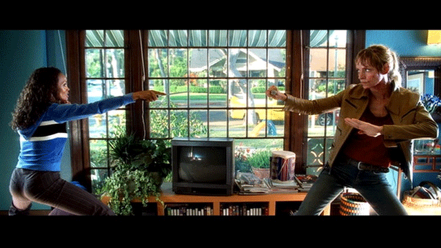

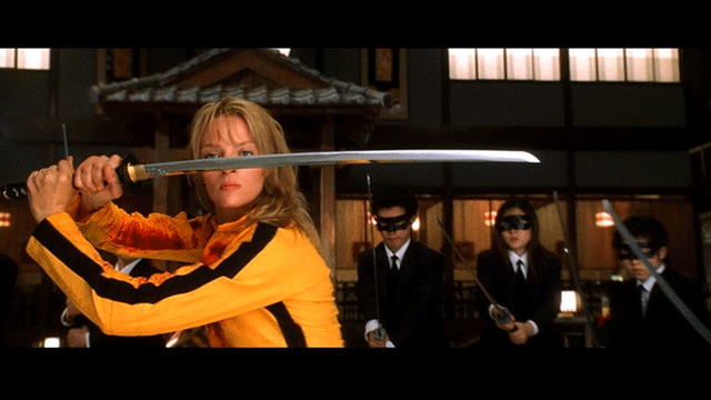

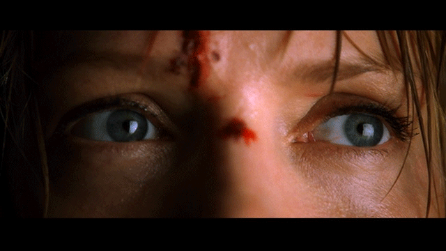

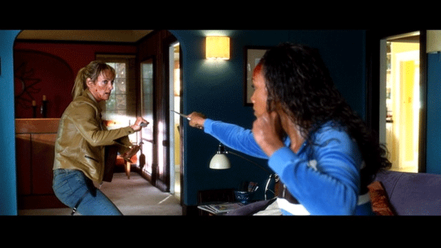

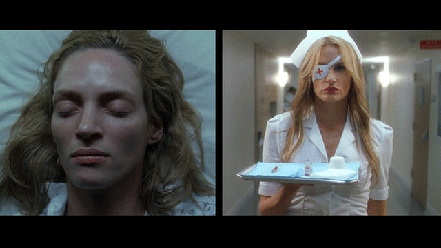

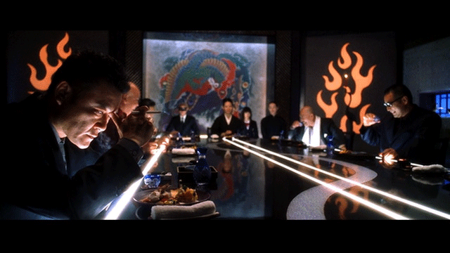

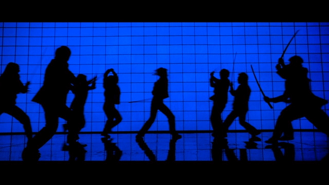

KILL BILL VOL. 1
This movie has an aspect ratio of 2.35:1 so I decided to use it as an example.
Below are image from the movie.
First is the image as it appears on a normal 16x9 TV
Second is the same image but "blown up" to fit the 16x9 TV
The first has black on the top and bottom thus preserving the original aspect ratio. This is how a commercial 2.35:1 widescreen video will look on a 16x9 WS TV.
The second is blown up to fit from top to bottom leaving no black but the sides get chopped off. This is what happens when you make a 2.35:1 widescreen video "fit" the screen size of a 16x9 WS TV.
Hopefully this will help illustrate the importance of proper aspect ratio because as you can see if the image is made to fit the screen ... well ... you are not getting ALL of the image.
CAT FIGHT
CAT FIGHT - CONTINUED
A SILENT DEATH? [SPLIT SCREEN]
BOSS ARGUMENT
SHOWDOWN AT HOUSE OF BLUE LEAVES
ULTRA CLOSE-UP [OR A NOD TO DIRECTOR LUCIO FULCI]
A BLUE WORLD OF DEATH
THAT REALLY WAS A HATTORI HANZO SWORD
As you can see a movie with an aspect ratio of 2.35:1 will have black above and below the image in order to preserve not only the correct aspect ratio but also so that the entire FILM FRAME is visible.
If you alter the image to fit the screen then you are not getting ALL of the image.

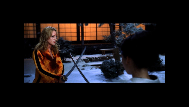

Another thing I wanted to bring up is the difference between DVD Videos that are "normal" widescreen and those that are 16x9 widescreen anamorphic.
Using a 16x9 WS TV here is what a "normal" widescreen 2.35:1 image will look like:
As you can see there is a lot of black on the top and bottom of the image. Also in my example the image is centered with gray bars on either side. Most CRT Rear Projection televisions use gray instead of black so as to avoid "burn in" issues. If the TV uses black instead then it would look like this:
This unfortunate situation is known as the "postage stamp" effect since you are getting a "small" image inside the overal "big" picture (or TV frame). Again this happens when you have a "normal" widescreen movie. Some call this 4:3 Letteroboxed.
Now 16x9 WS televisions usually have one if not more "picture modes" to account for this. If you are lucky you will have a mode that blows the image up proportionally. This means that the top and bottom get cut off so that the image fits from side to side. In this mode the aspect ratio is not altered and you end up with this:
This is exactly what you get when a 2.35:1 aspect ratio DVD Video is 16x9 WS anamorphic. The difference is that the image quality will be better as a 16x9 WS anamorphic DVD does not need the TV to "blow it up". When you have a 4:3 Letterboxed image and you have the TV "blow it up" then you will loose some picture quality. Thus most widescreen movies are 16x9 WS anamorphic for optimal quality on a 16x9 WS TV. Alas many older DVD release are 4:3 Letterboxed. Even today the occassional widescreen movie gets released 4:3 Letterboxed instead of 16x9 WS anamorphic.
It is important to note that you must use a picture mode that blows up the image in a proportional way to keep the aspect ratio. However most 16x9 WS televisions also have various "stretch" modes and those are to be avoided with 4:3 Letterboxed videos. Basically the "stretch" modes are made so that you can make Full Screen 4:3 video fit the 16x9 WS frame. Last but not least there are a few 16x9 WS televisions that sadly lack a proportional "blow up" picture mode.

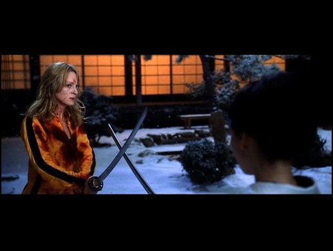

Just for the record ... if you were watching this kind of DVD Video on a standard 4:3 TV then you would see this:
Yes there is alot of black on the top and bottom but at least the image fills the TV from side to side. So there is no drawback to a 4:3 Letterboxed movie on a 4:3 TV but you do take a quality hit on a 16x9 WS TV when watching a 4:3 Letterboxed movie.
BTW the image above is the same for a 4:3 TV even if the DVD Video is 16x9 WS anamorphic. This is because the DVD player is made to reside a 16x9 WS anamorphic DVD to fit a standard 4:3 TV when the DVD player is set up correctly.
Now when watching a 16x9 WS anaomphic DVD Video on a 16x9 WS TV the DVD player will resize the image correctly but unfortunately when watching a 4:3 Letterboxed DVD Video on a 16x9 WS TV you must rely on the TV to resize correctly. Most 16x9 WS televisions can do this properly but there are some that cannot.
