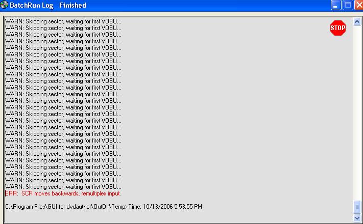

I used GUI DVD AUTHOR.
but when i enter create DVD i get this?
please help.
