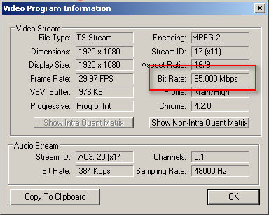

My SuperC 45sec test in VideoRedo ctrl-L info screen says its 9000+ but HDTV2DVD 45sec test file shows as 7800. If files size = bit-rate * 45sec formula above, the HDTV2DVD seams more true to what VideoRedo is telling me. -
No. ffmpeg can sometimes create bitrate spikes (i.e. bitrate going above the set max). Some players may not like this. Most are oblivious to it. So a cautious setting of 7800 was used to make sure that even these spikes don't go over the DVD max (of ~9800).Originally Posted by thymej

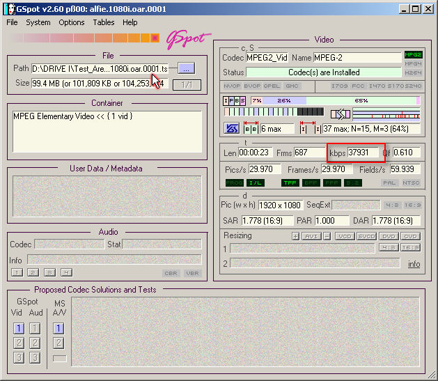

The nominal bitrate is written in the mpeg headers. This is the max value set in the encoder. It really has no bearing on the true bitrate. (you could tell an encoder to encode some end credits @ 8000kbs. This would be the nominal bitrate and you would see this in VRD etc. But the actual bitrate would be lower (as most of the frames a black))
So you get (from VRD):
but the actual bitrate needs to be deduced by parsing the file, (from gspot):
