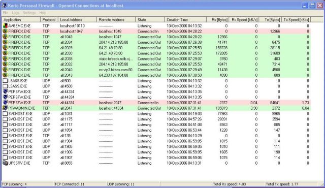

I'm a dialup sufferer too, don't know that piece of software but I use Kerio Firewall 2.1.5 (behind NAT router) and it has what you need and it's freeware.
Shown on Firewall Status screen:
I use NetLimiter to see what applications are using my connection and limit their bandwidth if needed. There is a freeware version called NetLimiter 2 Monitor that just monitors, identifies and lists how much each data each application is DL'ng and UL'ng: http://www.netlimiter.com/download.php It's a simple program and works very well.
