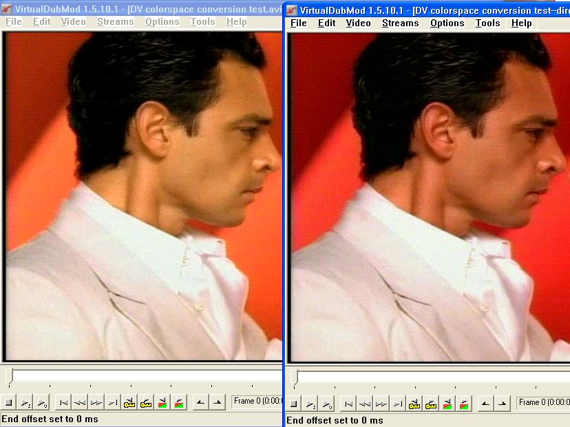

It seems that after encoding to MPEG2 the video changes it's colors to a darker/more reddish color. It's not too significant, but when comparing the original to the output you can surely see that the colors have changed.
Is this a normal reduction in quality when encoding to mpeg2? To filters were applied at all.

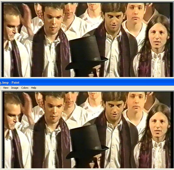

I tried directly encoding the original DV file in CCE. In this case I didn't really get darker colors, however I did get the colors to be more smudged. Here is en example(I lack a real image editing software at the moment so sorry for the way it looks), the top is the original, the bottom is after CCE. No filters applied.
In this case, the file didn't go through Vdub, but I guess there still is an RGB conversion in the middle since ffdshow/panasonic dv codec both decode to RGB?

EDIT: I tried making the colorpsace conversion in AviSynth(ConvertToYUY2(interlaced=true)). I'm afraid it didn't help and it looks exactly the same as when directly feeding CCE.
Is this color data loss(either the fact the colors get somewhat smudged, or occasionally darkened), a typical quality loss I'm going to have to deal with(it's not that bad, but I'd rather get almost 1:1 with the source)?
EDIT 2: Maybe it's the fact I'm using 16-235 lumiance level? should I use 0-255?
