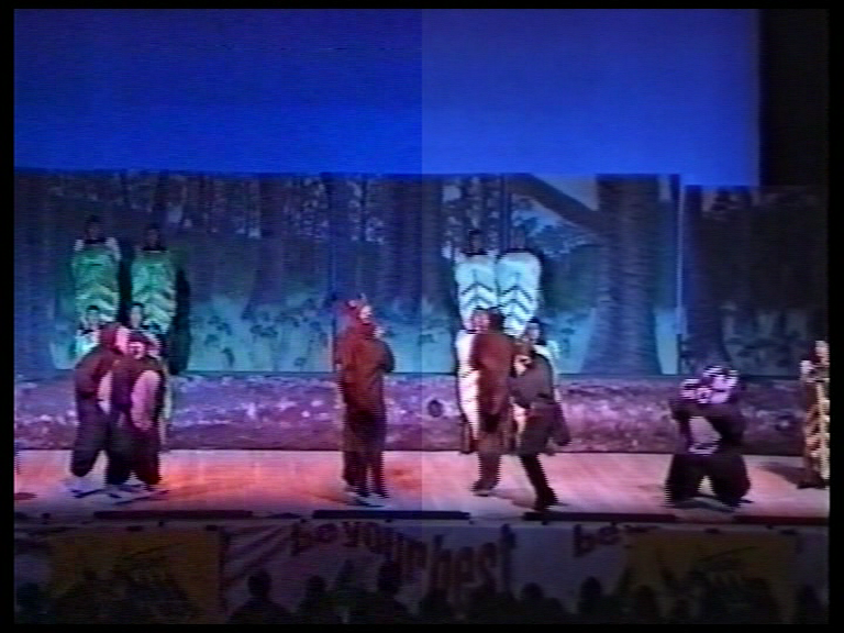

    You shouldn't have to encode to see the difference. You can use this script
    Orig_Clip=AviSource("original.avs",false)
    Rest_Clip=AviSource("restoration.avs",false)
    # Crop clips for comparison. Clips are cropped to create
    # a single complete frame
    Orig_Clip_Crop=Crop(Orig_Clip,0,0,360,0)
    Rest_Clip_Crop=Crop(Rest_Clip,360,0,0,0)
    # Stack the two halves together to finish up
    StackHorizontal(Orig_Clip_Crop,Rest_Clip_Crop)
    To view the before and after clips side by side. There are couple of restrictions though.
    1. Both clips need to be the same resolution
    2. Both clips need to be in the same colourspace
    3. This script is sized for 720 x nnn resolution. If yours differs you will have to alter the Crop statements accordingly
    You can just load this script into virtualdub to see a split screen veiw of the original and the changed version, without encoding.
    Read my blog here.

    No. The before and after windows in virtualdub only show you the effect of virtualdub filters. Any difference you are seeing is in your mind.
    What my script does is split the view in half down a centre line, and puts the left half of the before image and the right half of the after image together into a single screen. So you should see a half and half image in the first virtualdub window.
    You need three scripts to use this
    1. Script one is the split screen script as provided above
    2. Script Two is your LSF script
    3. Script Three is as basic as is necessary. In my case it is usually
    AVIsource ("clip.avi",false)
    ConvertToYUV2()
    Where clip.avi is the original clip that I am working on. You may need to use DirectShowSource in this case.

    I don't want you to change your original script either, except to make it work.
    These other scripts are in addition to your script, so you can compare your changes to your original quickly an easily. All three scripts - the simple script to load the origina lavi, the split screen script, and you LSF script should all go in the same folder. I usually keep mine with the original video clips as well. Makes it simple because you don't need to worry about paths.
    As for virtualdub - sorry, but it just doesn't work that way. When you load an avs into virtualdub, you will see the same image in both windows. Only if you apply a virtualub filter will you see a difference between the input and output windows.
    As an example of how I work, the current restoration I am doing involves a lot of noise removal. I have a folder on HDD2 which has the captured clip, the split screen script, the script to load the original, and about 8 (at last count) different scripts for altering the clip. They all happily live together. As a try different variation and combinations, I create new scripts, and alter the split screen script as I go to load the latest restoration clip.
    When I have found something that looks promising, I might test render a few minutes across to a folder on HDD3. Eventually, a full render will be done (in this case around 70GB worth), and from there an mpeg encoding will be done for authoring.
    Once you have the script to load the original avi, and the splitscreen script working, they don't need to change. Just alter the LSF script until it is a) working, and b) sharpening just the amount you need.
    At the moment you cannot say for certain if the LSF script is actually doing anything.
    Is how the output from the split screen script should look

  23. Yes, that's correct.
    Since you seem to be having trouble with this new concept, and no luck at all so far at getting it to work, I might ditto Abond's earlier suggestion and suggest making 2 scripts, one with LSF and one without. Open each in VDubMod at the same time (2 instances of VDubMod open at the same time), scroll to the same frame numbers in each, and compare them that way.
    That's how I made my earlier comparison pic:
    https://forum.videohelp.com/viewtopic.php?p=1586953&highlight=doctors#1586953
    Can you see the small one yet? If not, scroll down a couple of posts to the link.
    You really don't want to spend as much time getting a comparison script going as you did getting LSF going.

    The differences should be more obvious.
    And if you want an obvious split screen, in the 3rd script, the one that actually compares, create a black line between the 2 scripts:
    Orig_Clip=AviSource("PanicRoom-Full-NoSound.avs",false)
    Rest_Clip=AviSource("PanicRoom-Full-NoSound1.avs",false)
    Orig_Clip_Crop=Crop(Orig_Clip,0,0,360,0).AddBorder s(0,0,8,0)

    I put manono's script (above) into RestotorationScript.avs (long) and I open video in VirtualDub with Sharpen.AVI.avs.
    Everything works but no screen splitting or sharpening.
    Should I open Sharpen.AVI.avs in VirtualDub through "Open Video" or through "Run Script"? The first one works with result descibed above. The second gives error message.
    It looks like I am doing something wrong. Sorry.

    Here are the scripts if this could help.
    RestotorationScript.avs:
    Rest_Clip=AviSource("PanicRoom-Full-NoSound.avs",false)
    RestotorationScrip1t.avs:
    AVIsource ("PanicRoom-Full-NoSound.avs",false)
    ConvertToYUV2()
    Sharpen.AVI.avs:
    LoadPlugin("C:\Program Files\AviSynth 2.5\plugins\MaskTools.dll")
    LoadPlugin("C:\Program Files\AviSynth 2.5\plugins\MT_MaskTools.dll")
    LoadPlugin("C:\Program Files\AviSynth 2.5\plugins\RemoveGrain.dll")
    DirectShowSource("D:\WORK-LONG\PanicRoom-Full-NoSound.avi")
    Dull=Last
    Sharp=LimitedSharpenFaster(Dull,ss_x=1.50,ss_y=1.5 0,Smode=4,strength=1000,soft=30)
    Soothe(Sharp,Dull,25)
    Thank you.
