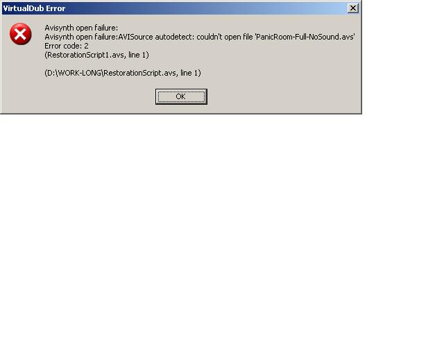

    Do you have a script called "PanicRoom-Full-NoSound.avs" ? os it it mean to be .avi ? These scripts need to be loading the video you want to process. Only you know what it's called.
    Read my blog here.
    Jun 2006
    Canada
    "PanicRoom-Full-NoSound.avs" ? os it it mean to be .avi ?"
    I do have "PanicRoom-Full-NoSound.avi" It is the avi I am trying to convert.

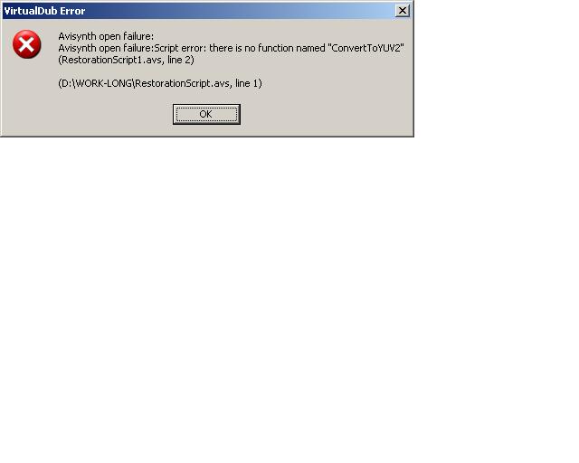

    Actually, there was a mistake I believe. In the short file it was "PanicRoom-Full-NoSound.avs". I changed it to "......avi".
    Biu when I try to open "RestorationScript.avs" in VirtuaDub, now I receive another error:
  5. Always Watching guns1inger's Avatar
    Apr 2004
    Miskatonic U
    Then that is what you need to have in your avisource or directshowsource statements.
    The error says you have a typo in your script and are trying to load
    instead of
  7. Always Watching guns1inger's Avatar
    Apr 2004
    Miskatonic U
    That's my typo. It should be ConvertToYUY2().

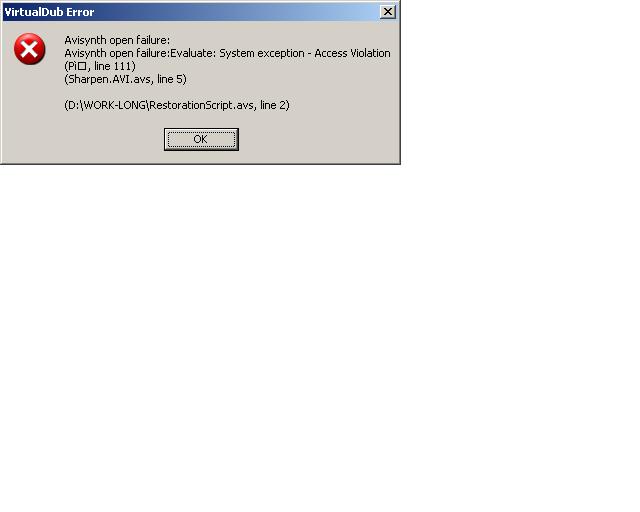

    I tried the second time. I had to wait for about three minutes (I copied your script to ....avs.
    Finally, afte those three minutes it gave error message:
  28. Always Watching guns1inger's Avatar
    Apr 2004
    Miskatonic U
    If you just load Sharpen.AVI.avs into virtualdub, what error is it ?
    I suspect that 20000 might have blown up something in the LSF function, so calling Sharpen.AVI.avs directly might remove some of the extra error messages.
    Read my blog here.
  29. Member
    Jun 2006
    Canada
    I tried the second time but both times I was trying Restoration.avs, not Sharpen.avs.
    The computer was roaring like hell but the second time produced the same error message.
    Then I tried Sharpen.avs instead of Restoration.avs, it gave almost the same error message. Just lines are different but it is the same error.
  30. Always Watching guns1inger's Avatar
    Apr 2004
    Miskatonic U
    Wind the number. Start with 17000. If that crashes, try 15000, then 10000 until it settles. Just stick with Sharpen.AVI.avs at the moment.
    Read my blog here.
