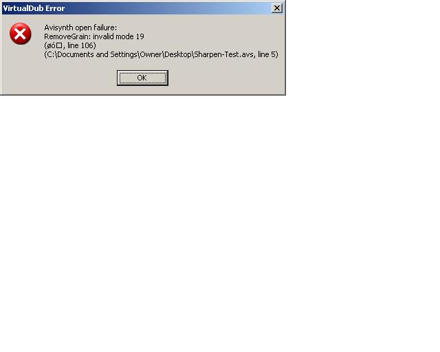

    I dowloaded Masktools 1.5.8 zip from the site that guns1inger mentioned above.
    But when I copied .dll I noticed that .dll itself is also 1.5.1.
    Should it be like that?
  2. Interesting. I just checked my version of 1.5.8, and it also says 1.5.1. Must be OK then.

    Anyway, I replaced the old one with the new one and tried again. No difference.

    Guys,
    I am pretty much sure that it is my wrong actions caused the problem.
    I do realize you have no chance to closely examine what I've done with Avisynth plugings directory or something else and you have hard time to find the way out of the mess.
    Sorry about that. I really appreciate your patience and intention to help. Thank you.
  5. I asked you to say what version of AviSynth you're using. Maybe you said, but I forgot.
  6. Always Watching guns1inger's Avatar
    Apr 2004
    Miskatonic U
    Can you post the code from LSF that you have in your avsi file ?

    Hi,
    AviSynth 2.5.
    Here is the LSF.avsi:

  8. 2.5 isn't good enough. 2.5.what? It's important, as you need one of the later versions (2.5.7 RC1 is (I think) the latest.

  10. Hi-
    I'm not saying you have to have 2.5.7, but I think you have to have something more recent than 2.5.5. As I mentioned before, if you're not sure of your version, make a Version.avs, with this inside:
    Version()

    Manono,
    I did as you advised. It is version 2.5.7.
    I probably should remove everything and start from scratch. Install everything anew.
  12. OK, your AviSynth is good. However, I found some significant differences between the LSF you posted, and what I have. Cut and paste this into your LimitedSharpenFaster.avsi, replacing what's there already:

    And did you make sure to have RemoveGrain 0.9?
    Anyway, try just:
    LimitedSharpenFaster()
    in your script after loading the DLLs you did before. Good Luck.

    Hi, manono,
    Actually I had the upper part initially but then removed till "function...
    I have done the changes as advised and downloaded another Removegrain (for sure 0.9).
    Now I have another error either in VirtualDub or in Procoder. Please see it below. Both started crashing when I try to open the file in them with the script:

  14. Actually I had the upper part initially but then removed till "function...
    I wasn't talking about the upper part, but the main body of LSF. For example:
    AMNT = string(soft)
    AMNT2 = string(100-soft)
    sharpdiff=mt_lutxy(tmp,last,"x y - 128 +")
    Mine:
    AMNT = string(soft)
    sharpdiff=mt_makediff(tmp,last)
    If it doesn't open in VDubMod, it either won't open or won't give you anything useable in Procoder. Do all your testing in VDubMod.
    That's all right, though, as you're almost there. We just have to sort out this RemoveGrain problem now. Whichever one you're using, it's the wrong one. Get both Ver. 0.9 and 1.0 pre and substitute them back and forth. One should work. Here, try this one:
    removegrain.dll
    Doing some more searching, it turns out both the top of the function and I were wrong. What's needed isn't RemoveGrain 0.9, but 1.0. That message for 0.9 was left over from the original LimitedSharpen function, and hadn't been updated for LSF. Here's the complete thing. Get it going with just the regular RemoveGrain before messing with the MMX versions:
    http://home.arcor.de/kassandro/RemoveGrain/RemoveGrain.rar

    manono,
    Thank you for your time. I will doanload removegrain 1.0 and install it right now. Please just give me a sec.
    Jun 2006
    Canada
    manono,
    I have installed/repalced removegrain and
    It works!
    Thank you!

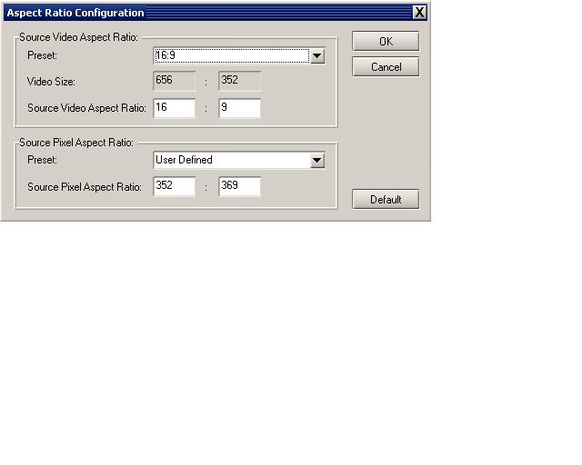

    Please if you would be kind to advise about the following.
    I encoded in Procoder the same avi movie two times ( from avi to 25 fps; then from 25 to 29.97 with pulldown; mux m2v with ac3 with muxman or rejig and burnt on DVD disk). Honestly, I am not sure that the settings were exactly the same.
    The first resulting DVD movie, when played either of my two standalones had black stripes on the top and at the bottom.
    The second resulting movie had top-bottom black stripes at all stages (avi; m2v; pulldown) including VOBs but after I have burnt it on DVD disk and started playing on my standalones, there are no balck stripes at all on either one - Panni or Philips.
    Which way is correct - with balck stripes or without? Did I do something wrong? Thank you!
  18. Finally, eh?
    Sorry, but I don't use Procoder and can't advise on the settings.
    If it's a widescreen movie and played on a regular 4:3 TV set, it's supposed to have black bars above and below. The player adds them in to maintain AR. Or they're encoded into the vobs. Or both. If played on a widescreen TV, and if the movie is wider than 1.78:1, then it's supposed to play with black bars above and below. Those black bars are encoded into the vobs. As long as the AR is OK (round things look round, and not like ovals), no problem.
    I have no idea. I'll need the GSpot info (including the resolution), a pic showing the black bars, and the AviSynth script, if I'm to figure it out.
  19. Always Watching guns1inger's Avatar
    Apr 2004
    Miskatonic U
    If you encoded a 720 x 480 at PAL framerates using the PAL template, ProCoder may have tried to create a PAL resolution frame. This is why you must encode to an mpeg file, not use the preset DVD templates.

    Jun 2006
    Canada
    Guys,
    I've found some settings in Procoder > Source that might affect the outcome aspect ratio.
    "Source Video Aspect Ratio" or "Source Pixel Aspect Ratio", which one should I use for aspect ratio or any one?
    Thank you!
  22. Always Watching guns1inger's Avatar
    Apr 2004
    Miskatonic U
    Your source should be 720 x 480 because of your avisynth script. If it is 16:9, just choose 16:9 and encode. If it is 4:3, choose 4:3.
    Read my blog here.
  23. Member
    Jun 2006
    Canada
    Thank you!
