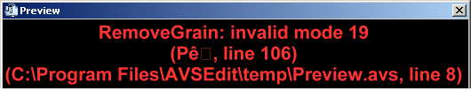

    Could someone help me with this. I keep getting an error message when trying to use limitedsharpenfaster. Below is the error message and my AVISynth script.
    LoadPlugin("C:\Program Files\AviSynth 2.5\plugins\masktools.dll")
    LoadPlugin("C:\Program Files\AviSynth 2.5\plugins\MT_MAskTools.dll")
    LoadPlugin("C:\Program Files\AviSynth 2.5\plugins\RemoveGrain.dll")
    avisource("E:\....avi")
    RemoveGrain(mode=2)
    #BicubicResize(704,454)
    Lanczos4Resize(704,574)
    LimitedSharpenFaster()
    AddBorders(8,2,8,0)
    ConvertToYUY2(Interlaced=False)
  19. Member Soopafresh's Avatar
    Jan 2004
    You've got the wrong version of Removegrain loaded.
    removegrain_1.0.rar
    Feb 2007
    China

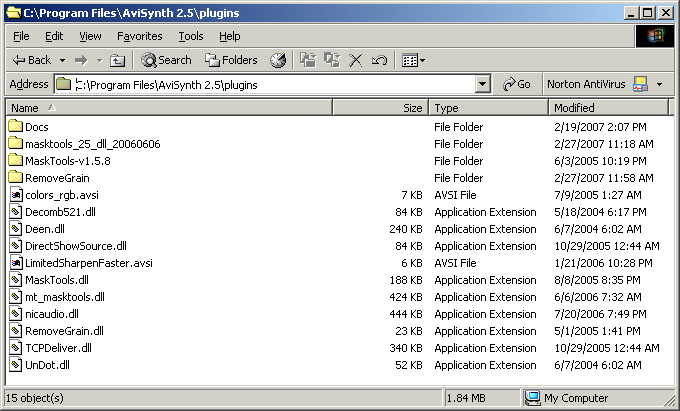

    ...and here is what my AVISynth plugins folder looks like:
  21. Member Soopafresh's Avatar
    Jan 2004
    Download the .rar file above
  22. Use this RemoveGrain:
    removegrain.dll
    Edit: Sorry Soopafresh. I didn't realize you were in the process of making the right one available.
  23. Member Soopafresh's Avatar
    Jan 2004
    No problemo You might have the correct one anyway.
  24. Member
    Feb 2007
    China
    Yep. That did it. Thank you both. One minutre response from Soopafresh . I love this forum.
