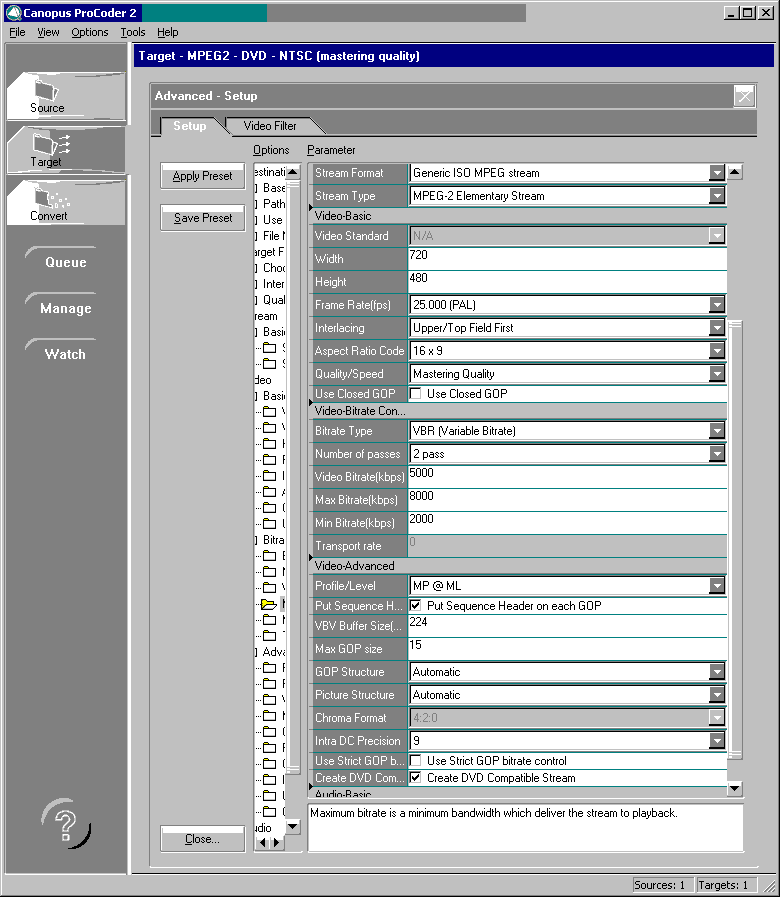

In order to create a 25 fps 720 x 480 output you have to output a generic mpg, not use the DVD template. This opens up a lot more control.

Is it what guns1inger meant: "In order to create a 25 fps 720 x 480 output you have to output a generic mpg, not use the DVD template." - What is a generic mpg? How can I create it?
You mentioned: "use alternate scan type, and not zig-zag scan type" - I do not know such settings in Procoder. Where are they?

Hi,
As advised I tried to create a 25 fps 720 x 480 output with generic mpg (Please see the settings of the Target mode below).
Procoder again encoded only part of the movie and stopped encoding at the same spot as it did in the previous tries. DGMPIndex shows the resulting video is interlaced though I do not see interlacing while playing on PC.
After that I appllied pulldown and converted m2v file (there is also d2v file but I did not touch it) to 29.97. Created VTS with VOB with TSUNAMI-MPEG and burnt it. My Panasonic does not read the resulting DVD. Philips reads it but the picture is broken to small pieces. PC players do not read the DVD at all.

"do you see the whole file in virtualdub when you load the script?" - Procoder has preview option in the Source mode and I used it to check whether the whole file is present. I loaded the script and I could watch the whole movie from start to end in the preview window.
Thank you!
Everything there looks OK, except maybe Create DVD Compatible stream. As you are mixing PAL framerates with NTSC resolution, you aren't really creating a compatible stream.
I don't believe the problem lies with ProCoder, but with your source. The fact several attempts in a row have all stopped at the same point indicates some sort of issue. At this point I don't know what else to offer you, other than to say - this is why I don't do format conversions.Read my blog here.
