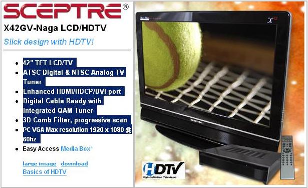

Kurbads,
Hmmm. If it doesn't exist. Then I've been having alot of fun dreaming the last couple of months.
http://www.sceptre.com/Products/LCD/Specifications/spec_X42GV-Naga.htm
I've had two Sceptre 19" LCDs (X9-Gamer) for over a year now and jumped at this TV once I saw what it had for options. First, I wasn't going to buy anything less than a 1080p since I was doing PC (and HD-DVD once its available for the Xbox360) on it. Otherwise, the price drops on the 720p models are great and would have gone with that. At 42" or less the difference (visually) between 720p and 1080p is negligable for most.
There are no 1080p LCDs out there? Hardly...
(PS: I actually set my resolution to 1920x1200 instead of 1920x1080 to get it to work. Nice and clean though)
Have a good one,

Originally Posted by neomaine
Response Time 8 ms (Tr/Tf ms) "
"PC VGA Max Resolution 1920 xPC / Mac,
VGA/SVGA/XGA/SXGA/WXGA 1080"
"PC Input Max resolution 1920 x 1080 @ 60hz"
That one appears to do the job.
http://dealnews.com/deals/Sceptre-X42-GV-NAGA-42-1080-p-LCD-HDTV-from-1-600-shipped/132897.html
PS: 1920x1200 is WUXGA, that would need to be vertical scaled by the monitor or the monitor is cropping to 1920x1080.
http://en.wikipedia.org/wiki/WUXGA -

kurbads,
Sorry about leaving off the European version of the Sceptre. I had meant to edit that out (and will). When I went to the Sceptre site and clicked on Europe on the opening page, it brought me right back to the same product lisintgs, so I thought. I had intended to add the link for you if there was one but didn't find one. Maybe you have.
Either way, the point was that there ARE 1080p LCD TVs or monitors available out there.
edDV,
It must be rescaling since I'm not seeing anything cropped, the whole desktop is available. Thanks for the lookups for letting me understand how/why, though. Much appreciated.Have a good one,
