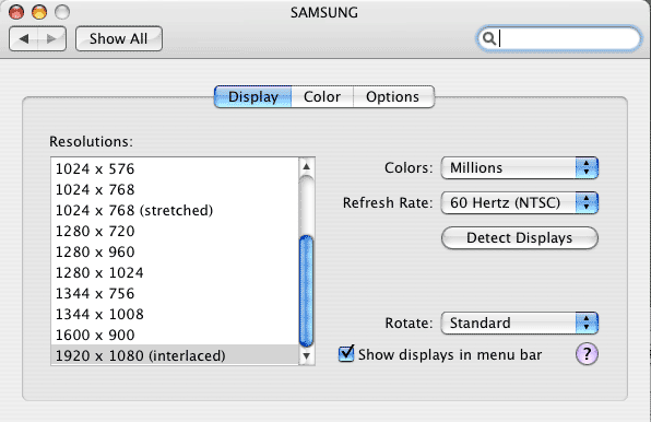

	OK, only two years of waiting and I finally bought a Full HD TV last December which connects fine to my MacMini through DVI. It is Samsung 40F86. I bought it for around 1500$. But there are two issues.
 First OSX displays progressive mode only when in safe mode or when boots from install disk, or in terminal mode. When booted normally it shows only 1920x1080i as maximum resolution. Probably it is better for the video card. Besides it is no way noticeable except when hovering mouse over playing video - the odd and even lines can be spotted on pointer.
 The second is playback of 720p HD content (MacMini 1.66 CoreDuo can't do 1080p H.264). Small jumping is noticeable especially on movies subtitles at the end. It looks like software player is adding frames to match the refresh rate. There is smaller jumping and larger. The larger one becomes stronger when 100Mhz Motion Plus is turned on and small jitter disappears. But it is also present when Motion Plus is off. The small jumping differs when computers video is set to NTSC (60Hz) and PAL (50Hz). In PAL mode it is quicker. The bigger jumping stays the same in both modes.
 The videos usually are 23.976fps, H.264. I thought the player plays video at faster - 25 fps to match the refresh rate when in PAL mode and plays faster and duplicate every 4th frame (23.976->24+(24/4)=30) in NTSC mode. But it looks like it is not increasing playback speed but is constantly nonlinearly adding frames here and there. The picture stays the same in all players - VLC, MPlayer OSX, MPlayer OSX2, Miro.Cann't tell it's possible don't tell anything.
