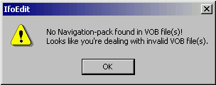

    oh no !
    I've tried the "Mock Strip" on VTS_01_0.IFO and IFOedit said :
    Is this the end ?
    Is there anyway to recover from this ?
    Thanks.

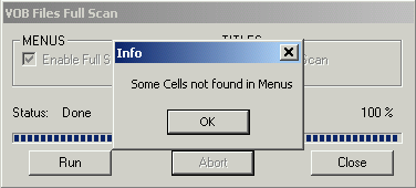

    Feb 2004
    ok, I'm guessing I need to do the "Mock Stripping Menu's" not "Mock Stripping Titlesets" ?
    That doesn't produce an error !
    Is this correct ?

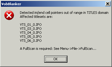

    Also, I don't know if this helps but VobBlanker says :
    After running the full scan, it reports :
    Any ideas ?
  6. Hi-
    Not really enough information here. You opened the complete, original DVD in VobBlanker with no problems, right? What happens when you open the original DVD in DVD-Rebuilder? It gets accepted, right? So, for some reason, after removing the stuff you don't want using VobBlanker, DVD-Rebuilder no longer accepts it. Is that right? And nothing you've done so far fixes it, right?
    What did you remove with VobBlanker? And how did you do it? I'm assuming you processed only the VTS's from which you removed stuff. You may also have replaced what you processed incorrectly. That is, replace everything that's in the new folder, and not just the VOBs. Stick back the new IFOs, BUPs, and VOBs. Then run a Get VTS Sectors in IFOEdit. That's how I do it with no problems.
    My suggestion is to start again with the complete untouched DVD. Test it to see if it opens OK in PGCDemux and also in DVD-Rebuilder. Then open it in VobBlanker, remove what you don't want, and Process everything, even the stuff you're not touching. That is, don't "Skip" anything. So what if it takes a few extra minutes? That way there's no chance of user error.

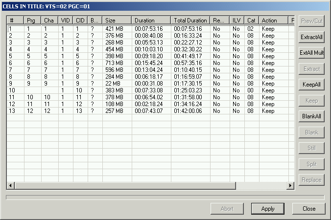

    The only thing I'm "nervous" about is creating the 'scene selection' menu's ? Is this tricky ? I assume the official scene breaks are as per the image below from VobBlanker? Is it easy to make my scene selections the same as these ?
    Thanks again.
  10. Hi-
    Yes, it'll be fairly simple to get the chapters at those same places. The only thing is that different authoring apps use different formats for the chapters, variously different time formats, or different frame number formats. So, you'll have to get them in the correct format. Some take them in that exact form you showed in the pic, hh:mms:ms. ChapterXtractor can get them for you very quickly in a variety of formats, as can DVD Decrypter when decrypting (Tools->Settings->IFO Mode->check the ones you want).
