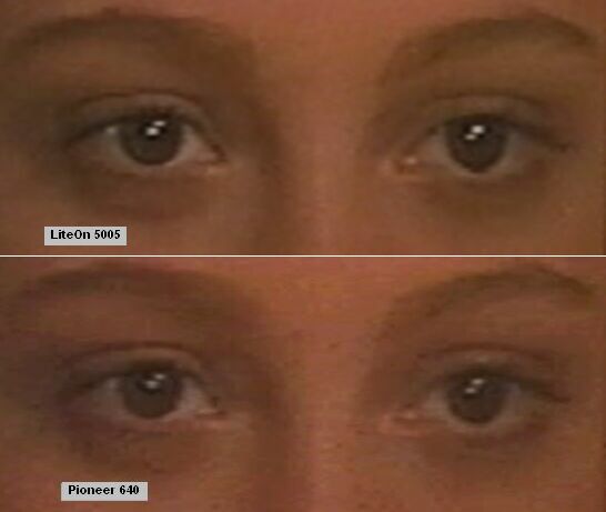

While the Pioneer 640 is an otherwise terrific DVD recorder, if your primary reason is to back up VHS tapes, you'll be disappointed. I have gone back to using my old LiteOn 5005 for VHS transfers since it blows the Pioneer away with a much better picture, particularly as far as less pixelation and better detail is concerned. I always thought of the LiteOn being on the soft side till I bought the Pioneer.
Even with all the Pioneer's input settings (black level, white level, hue, chroma, YNR, CNR...), it can't match the LiteOn's better picture, and to me exhibits an unacceptable amount of video noise on recordings made from video tapes, including too much pixelation in dark areas. This happens even when using the best (XP) quality settings.
On the other hand, the Pioneer is much better in the "true Color" department, which the LiteOn lacks (even with the firmware upgrades, there is still a slight greenish hue with the LiteOn). The Pioneer is also miles ahead when recording off the tuner.
From digital cable, recordings are good, with truer color, but noticeably softer (less detail) than with the LiteOn, regardless of the bitrate setting. If Pioneer were to use some of the LiteOn's filter technology (LSI chip?), you'd be close to getting a near perfect DVD recorder (all my own opinions of course)... -

I did use the"VCR" presets initially, and only after getting poor results I tried every other possible setting trying to improve the picture quality. I'm sure you are aware that by pressing "Display" on the remote, you can see the factory settings for "Tuner," "VCR," and "DTV / LDP" recordings, so for "VCR" the only difference is what amounts to noise reduction ATTEMPTS (25% YNR, and 25% CNR), which - in addition to reducing detail - does not improve, but rather worsen picture quality.
The LiteOn has no such adjustments but does a beautiful job in reducing video noise, while retaining a decent amount of detail, which can indeed make the copy look better than the original if it was LOW quality, but never if it was HIGH quality to begin with. Nevertheless, one tradeoff is still reduced video sharpness. BTW, I have experimented with S-Video and composite cables, a cheap 'black box' to help frame synchronization, and a full-frame TBC. Only when using an SVHS source (higher resolution) does the Pioneer exhibit similar results to those of the LiteOn, and in addition displays truer color fidelity.
Don't get me wrong -- I love the Pioneer 640 and its many great features, but I don't agree that the quality of VHS transfers is one of them.

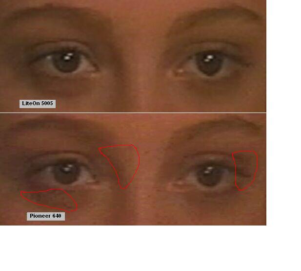

I would have to agree. This is not just resolution. The Pioneer image seems to show signs of blocking in the circled areas which is typical of noise getting to the mpeg processor.
