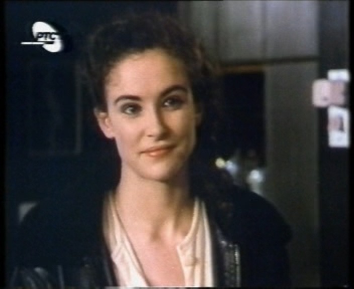

  1. I posted on doom9.org my little denoise comparation test. Source is very very bad VHS tape with much noise.
    So go to:
    http://forum.doom9.org/showthread.php?t=116261
    see result and try with your way to get better result.
    Source is here:

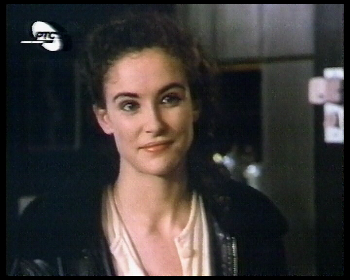

  7. I put Readout=True and Dot=True and have two numbers on left corner and i have little green pixel. See pic:
    I am intersting few things about peach:
    1. firstly number 10.345 is NoiseLevel and 7.133 is Baseline.
    2. When testing script with peach, does i need just to write in script Readout=True and Dot=True without filter parametars (like noise reduction,spatial...)
    3. How do i now that dot is sold. And if is sold what to do? Because in some frames i see green dot and in others i dont see green dot.
    4. In movie if i found the highest number(for noiselevel and baseline) than i need to fill that in script, right?
    5. And when using another filter in conjuction with Peach, what you prefer, first to find noiselevel and baseline and than apply another filter(convolution or vague....)
    6. Do you think that this is better method using peachsmoother instead his "automatic" mode.
    Once again, sorry for many question but i am interesting to understand best way to use pich smoother.
    this is clipeachsmoother (NoiseLevel = 10.345, Baseline = 7.133, NoiseReduction = 80, Stability = 30, Spatial = 100)
