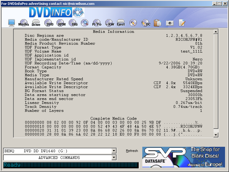

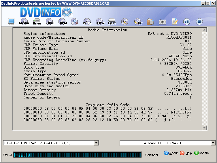

Could you load that +RW into DVDINFOPRO and snap a pic of the media info for me. The Apex wouldn't really tell you the book type would it? What you are telling me could change everything. Like I said it's hard to get detailed reviews and there is a lot of misinformation out there that's why I'm cautious.

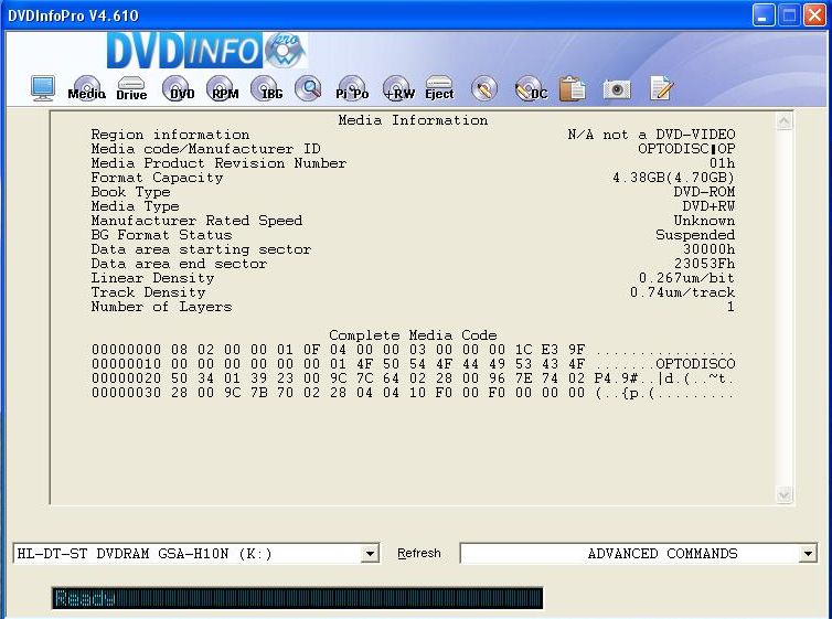

The LG GSA-10N does allow booktype setting to DVD-ROM for DVD+RW with stock firmware. You just set it in Nero options changing it from Automatic to DVD-ROM. This series of burners puts out excellent quality check disks witn Verbatim +/- R media. $33 delivered thru Newegg.com. It is a Hitachi OEM. The LG GSA-10L Lightscribe model would suit you just fine and provide the bitssetting you want.

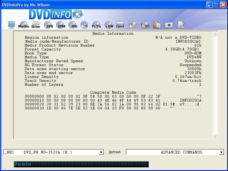

I could take a similar picture with my LG but the +RW blank disc had already been bitset to DVD-ROM in my NEC-1300. The LG and Nero will not override my setting if I set it as you describe no matter how often I write over it as long as I don't reformat.
If I use a new or reformatted +RW and try to set it with DVDINFOPRO and then try the same thing with Nero the burned disc will show as DVD+RW in the book type when I check it with DVDINFOPRO.
Can you confirm how this disc was bitset from blank or fresh format?

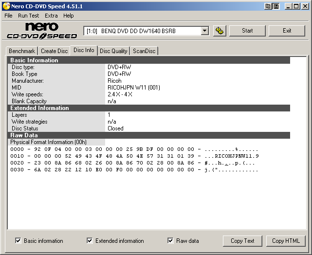

The BENQ 1650 bitsets to dvd-rom out of the box for DVD+RW media. You can use the BENQ tool called QSUITE 2.1 to set the DVD+RW to bitset to dvd-rom or use it as physical disc type in NERO BURN. The BENQ 1650/1655 have the same hardware the only difference is the lightscribe feature.

, I apologize, I took a blank and burned it and it DID NOT set it to DVD-ROM.....My NEC 3550 must have did it when I wasn't looking

Here's a DVD+RW disc burned in a PIONEER 111L drive with 111L tdb 8.26 internal firmware
Here's the info from DVDINFO PRO & CD/DVD SPEED:
