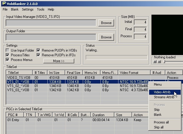

  2. You can change from aspect ratio in DVD from 4:3 to 16:9 in VobBlanker.
  3. I just tried that (i'm not the original poster, but I was about to post the same question) and it didn't work.
    I have a DVD I recorded from SCI-FI channel and it was originally a 16:9 picture inside a 4:3 frame. (Eureka) When I changed the aspect ratio as shown above I get a 16:9 picture, but the black bars at the top and bottom are encoded along with the picture so I still end up with the same problem. What I need to do is find a way to cut off the black bars entirely so the 16:9 picture fills the entire screen. My TV doesn't have a zoom feature that will do that for me at all.

    You need crop black bars and reencode to 16:9 mpeg2
