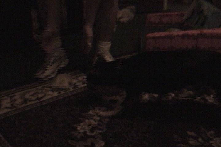

    I've put a sample of this avi at http://jraigrimmer.tripod.com/stitch.avi. It's a DV clip from my Sony Digital8 camcorder, so you'll need a DV codec to use it. I use the Panasonic DV codec, therefore the converttoyuy2 is required to use the convolution3d filter. As you can see, the clip is quite dark. I've applied some AVISynth filters to it and thought you folks might be able to guide me as to how I could improve this clip more.
    Here's a frame from the original.

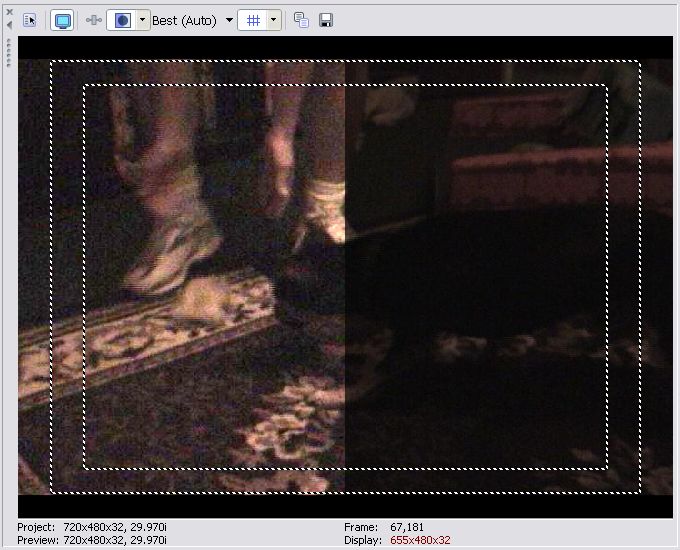

    This is the Vegas levels filter only stretching 30% luminance to 100% (split screen to original).

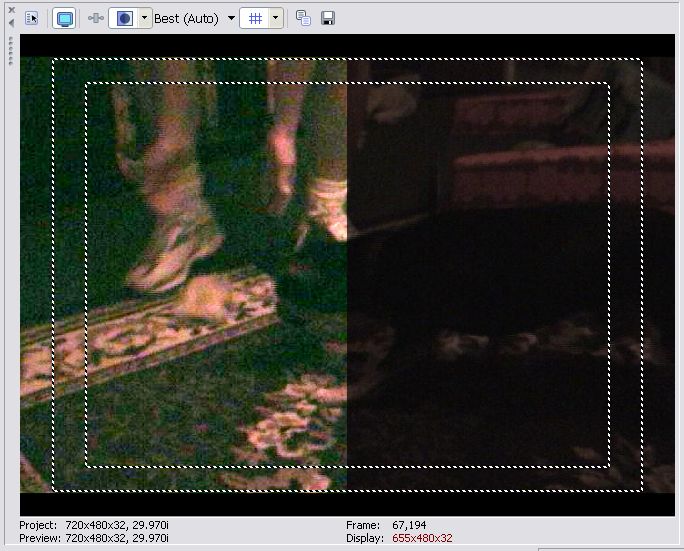

    Difficult to pull any green out of the rug. Playing with color correction filter.

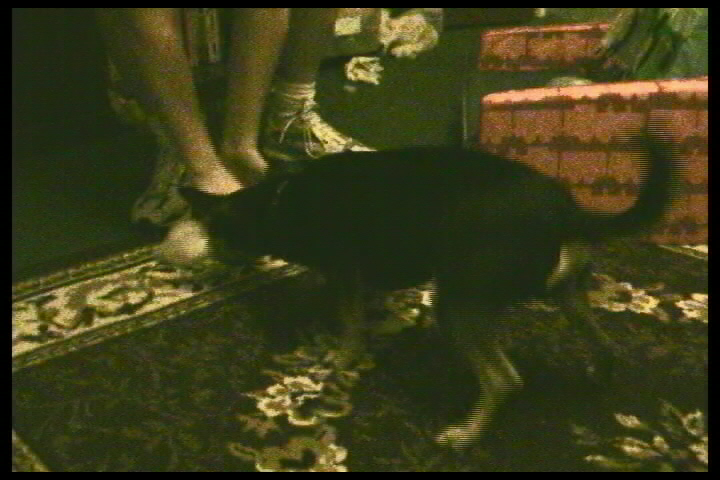

    This link has a copy of the avi after being filtered, and a copy of the script. It uses PeachSmoother, VagueDenoiser and Colormill. I also had a go with Convolution3D, but didn't get results that were any better than the method I eventually went with. Bringing up the colour and luma values increases the noise substantially, so in the end you have to find a balance between darkness and noise.
    Anyway, here is the link. Use it if it works for you
    http://rapidshare.de/files/33881291/stitch.rar.html
    And a snapshot from the clip (to save you downloading it if you don't like it)
