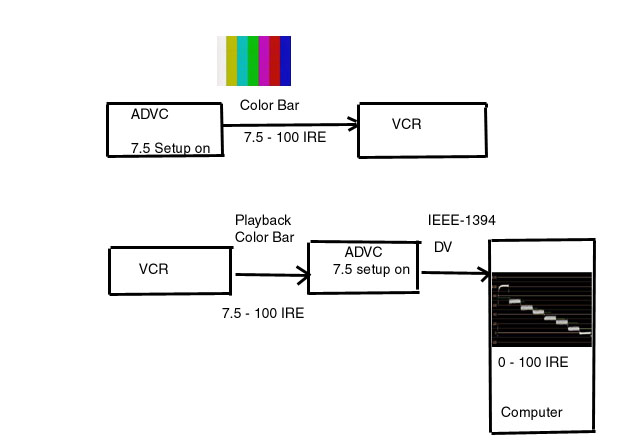

Basic ADVC rules for NTSC.
1. Make sure "setup" switch is in the 7.5 IRE position.

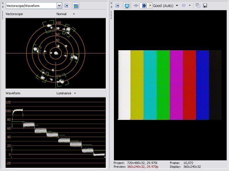

2. You can check calibration of the VCR by recording the color bar from the ADVC to the VCR (composite or S-Video). Then play back the color bar and capture with WinDV. Then post a few frames (<2MB). I'll look at them on the scopes.
7.5 IRE should map to DV level 16
100 IRE should map to DV level 235 -
The Canopus is set to 7.5 IRE.
I will try the color bar test, I have to find a blank tape and figure out how to make color bars on the Canopus to record.
Thanks for helping. -

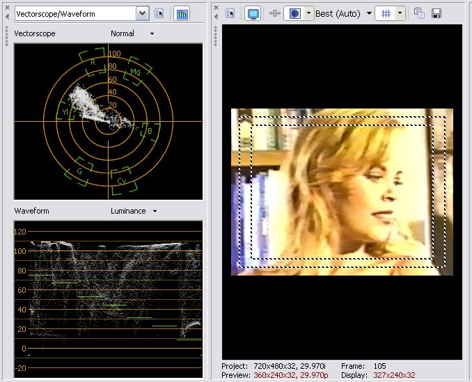

Is that a commercially recorded tape? If not try one. Those will have good record levels.
This picture is high on output level at least 10%. Parts of it are clipping at level 109 (digital 255). Blanking (left and right lower edges) is correctly at -07 (digital zero).
If this is a commercial tape the VCR ouput level needs adjustment (internal pot). The ADVC-300 has a level setting function to compensate (see manual).
Once luminance level is adjusted, then saturation can be evaluated.
PS: That picture also looks like the setup switch may have been in the 0 IRE position rather than 7.5 IRE. Black (around the books) is high. -

My thoughs:Originally Posted by Endemoniada
First determine if the VCR needs service by playing a known good commercial tape.
If the problem is the way your "masters for music videos" were recorded, then you need to correct levels before capture. The ADVC-300 has controls for Luminance Gain (black), Contrast (white), Saturation and Hue. These will allow capture without clipping.
There isn't much you can do to fix a picture like above. You need to recapture with proper levels.
