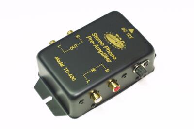

I went to Radio Shack and took a look at their low cost pre-amp they have ($99). The way the man told me was to use use both the amp that came with the phonograph and the pre-amp from his store. I need the first amp to give power the turntable but I plug the RCA audio from the turntable into the RCA audio in of the pre-amp and then the RCA audio out of the pre-amp into the RCA audio in of the DVD/CD recorder. -
Get this for $29.00, at : http://www.phonopreamps.com/tc400pp.html and follow their hook up instruction. It comes with all the cable you need.
Note : Sorry that your local radio-shack man is that dumb.
Note : This should go back to your original "LP to CD" thread. -
WOW! That's the best thing yet. That's sure a lot better than buying that $99 pre-amp from Radio Shack. Thank's alot for the info and I will see if I can either close the other thread or at least post that the problem has been solved.
The only thing I question is what do I use to power this gismo? I see that it has a 12V power on it. Does it come with the 120/12V adapter? -
OK, never mind above question. I see they include the adapter. I still need to power the turntable however so I will still need the original amp because it has the correct plug for the turntable to plug into to get power to it.
