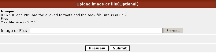

    How do I attach or post pictures? Do you want images of the software menus I use (for volume)? Do you want an image of the three sockets on the back of the computer for the audio? Do you want images of the cables and microphone?
  15. PC normally has three sockets for audio, mic in, line in and headphone out. Yours is different. So far, can your hear windows sound, or CD audio from your PC ?
    When in postreply, browse to the image file and upload, using this :
    You can scan, cam your manual, jacks, or put the section on page, and press alt and print screen, then paste into graphics editor, and save to a jpeg file.

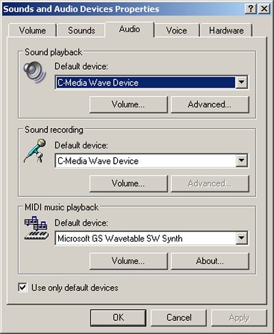

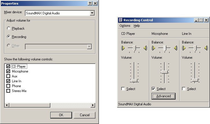

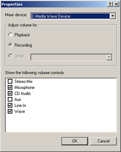

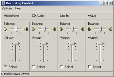

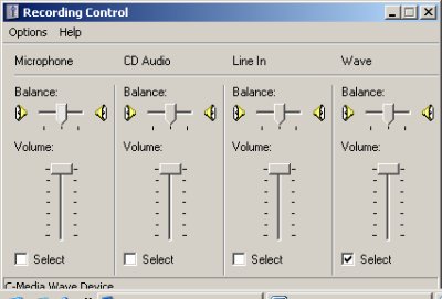

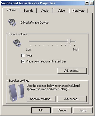

    Well, capturing a few dialogs was easy enough, so here's a sample. I see my image post problem. I was in quick reply. Here goes. Let's see if all four files make it.
  18. Member solarblast's Avatar
    Nov 2004
    N. California. USA
    Hmmm, one file limit? OK, here's a second one.
  19. Member solarblast's Avatar
    Nov 2004
    N. California. USA
    And a third.
  20. Member solarblast's Avatar
    Nov 2004
    N. California. USA
    Number 4. The last.

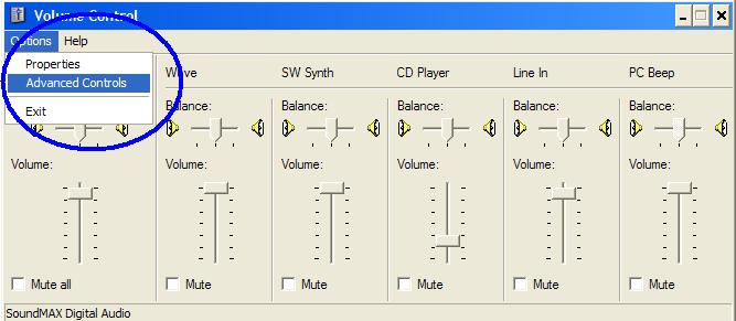

  21. Based on your post, you selected microphone as your input but you did not turn it on. It did not look grey out on your picture. It should be checked like this :

    Yes, I forgot to make the selection there, but still no bananas when I do. See attached. Note the absence of the "Advanced" button.
    How did you get two images into one message? I tried a cursor multiple selection and that wouldn't work.
    My mic is a 10-12 year old Sony from an old 7" Sony tape recorder. It does work when I plug it into my RShk portable tape recorder.
  23. Plug your CD player with very low volume into the microphone jack. Turn on sound recorder with its red record button, and look for the wave.
    If this still don't have sound, then you may have a broken board.
    Note : I used microsoft photo editor, and paste new image to combine images.

  25. So, just to confirm, this menu option is greyed out...right?
  26. Member solarblast's Avatar
    Nov 2004
    N. California. USA
    Only the Advanced Ctrl item, but not the Properties item.
