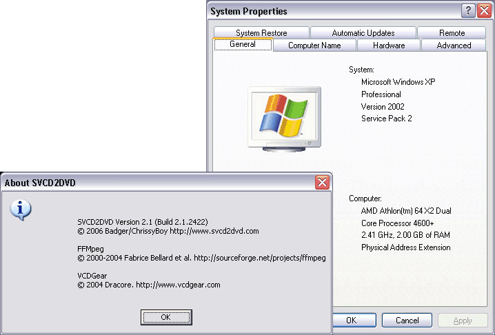

I recently upgraded my PC from an AMD3000 cpu with 1gb DDR3200 to an AMD4600 X2 (Dual core) with 2gb DDR2-6400. Encoding used to take about 2.5 hours but now it has more than doubled in the time it takes (approx 2.5hrs to 5.5hrs), I would expect encoding to be a bit quicker with the upgrade but this is definately not the case here.
After a fresh reinstall of WinXP-Pro and installing all the updates, I installed the latest SVCD2DVD build which is/was v2.1.2422.
My question is: Does this build run slower than the previous build I had installed?
(dont know build number but it was fairly recent).
My PC registers as an AMD 4600 dual core with 2gb ram, to the best of my understanding, the memory timings are also set correctly in the bios. (4-4-4-12)
Please help, is it the new software build or is it my PC. I am suspecting the reason is my PC.
Could it have something to do with the dual core CPU?

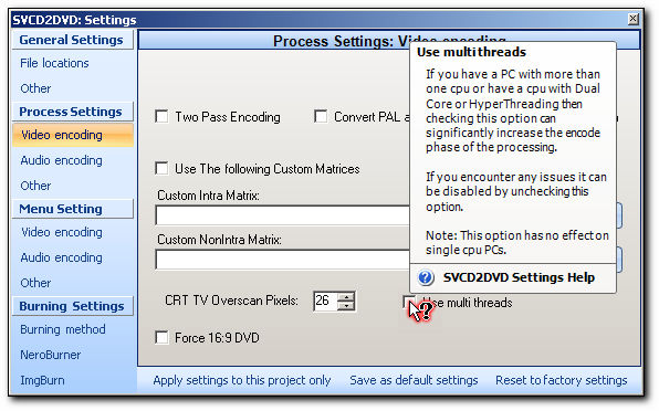

ok. Have you tried using the multi thread option:
Are you using 64bit XP?
In the first instance i would concentrate on the encoding duration. From that log it is taking an hour to encode 45 mins... That is too long. Try the thread option and just process one of your files to see if there is any differenceSVCD2DVD v2.5, AVI/MPEG/HDTV/AviSynth/h264->DVD, PAL->NTSC conversion.

The dual cpu option must have done the trick.
I have just completed a new dvd in about 3.5hrs which included burning time!
