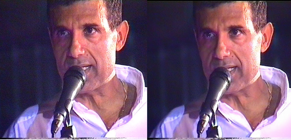

Here's an example of my progress on the testing clip I'm currently working on.
This is just a picture, but I chose one that you can easily see a character's face to see the difference.
For this movie anyway, this is the best results I was able to achieve when taking into consideration both reducing noise and keeping quality(less blur).
I'd be happy to hear your comments, because this seems like a serious enhancement to me.
I'd like to mention that this is a closeup stilled frame. So the amount of blurring you do see is hardly(if at all) noticeable when the movie is streaming.

It's just my opinion, but I like the unfiltered version better. The filtered one is too obviously filtered.
I like the filtered one. Don't confuse noise with detail.
