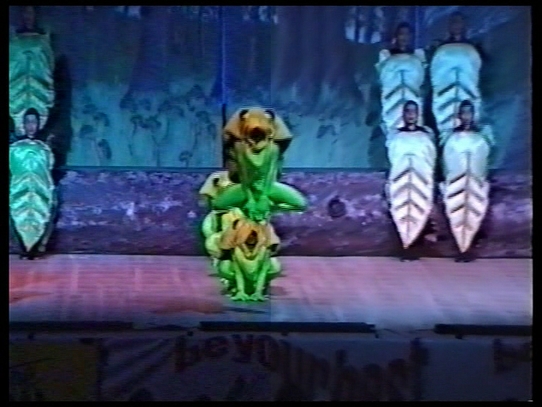

    I know stills don't do the same justice as video, but these are from the video I'm working through at the moment. Left side is original, right-side is PeachSmoother (with the settings from above, give or take) and the vdub filter colormill
    Read my blog here.
  27. guns1inger does this samples is divx or dvd?
  28. Always Watching guns1inger's Avatar
    Apr 2004
    Miskatonic U
    DVD. These came from VHS source, capped through a TBC-1000 and then A/D pass-though on my Panasonic DV camera to the PC as interlaced PAL DV avi. These were processed through avisynth encoded at CBR 7600 kbps as they are part of a short multi-angle test. The final clips are encoded at around CBR 8700 kbps + audio.
    The screen grabs were taken with VLC from the interlaced PAL mpeg2 footage. The tape is ten years old, but some of the footage on it is 5 - 6 years older than that, so this is 2nd and 3rd generation dub in some cases.
