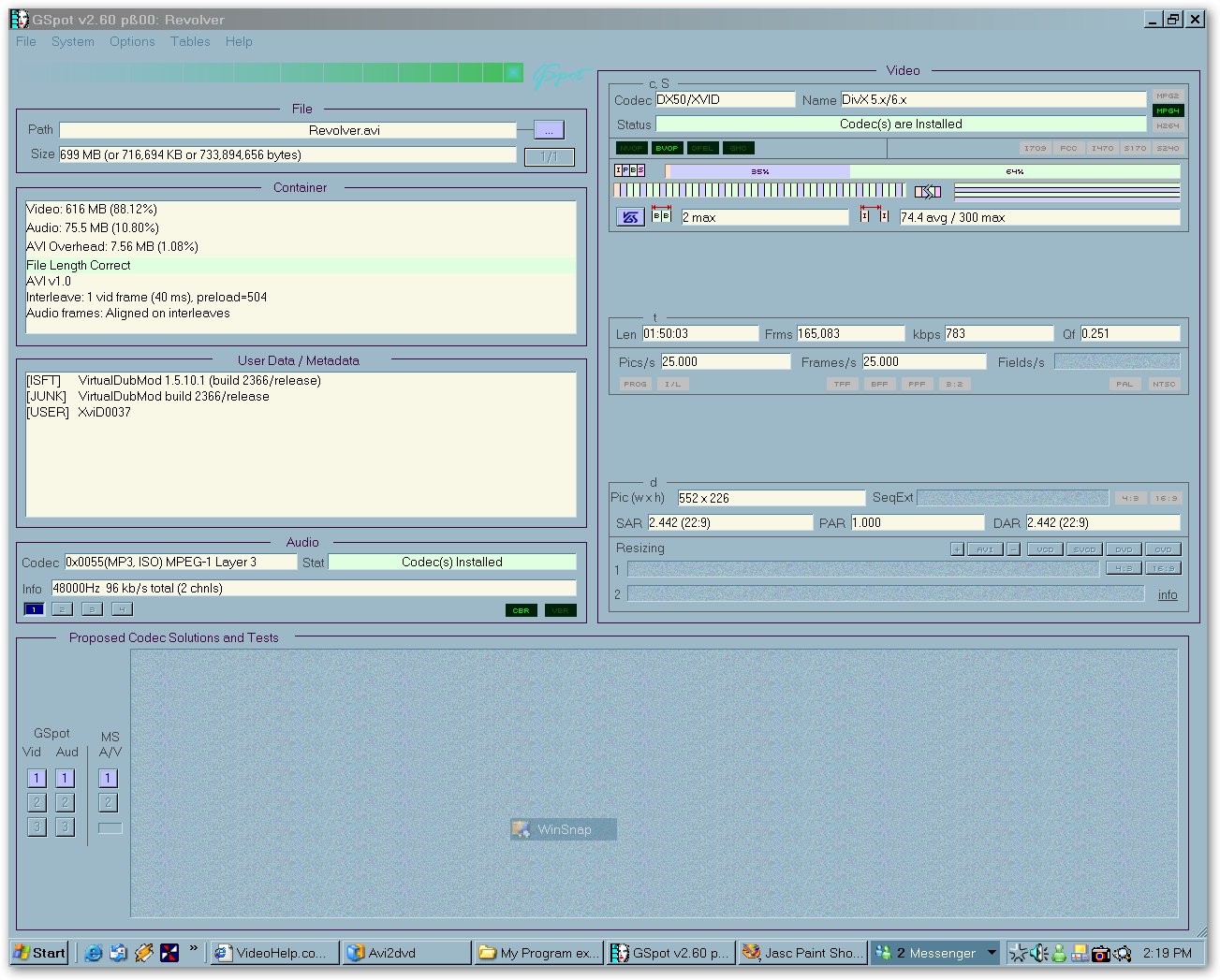

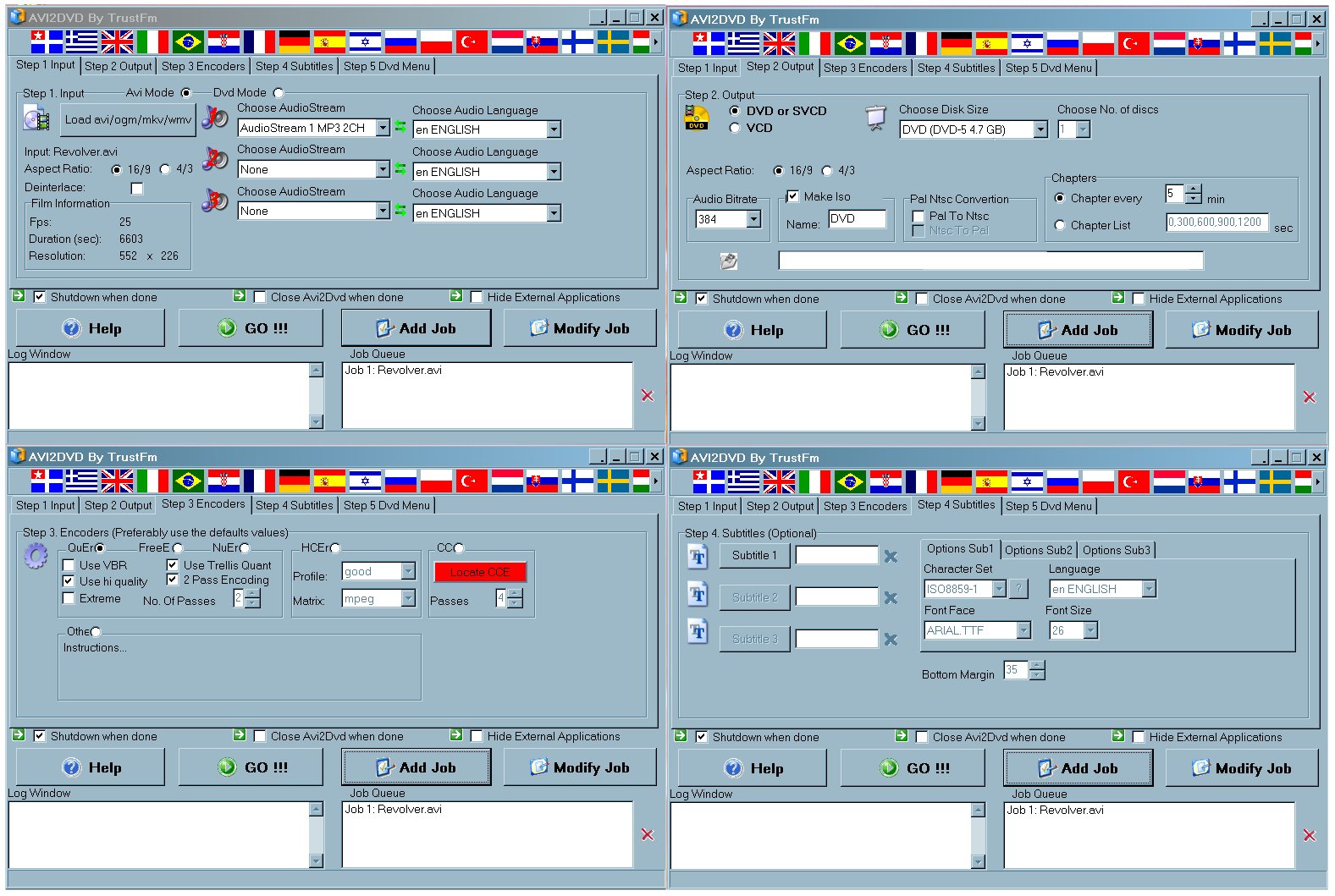

Here is the AVI2DVD capture. I will post the gspot info in the next post.

One of the problems you're seeing is you are starting with a 5xx wide picture and you're magnifying it to 720 pixels wide for DVD, so any flaws that you see will be magnified, and any artifacts in compression magnified as well.
As you do have DIVX player, leave it as DIVX and just burn some data DVD's with the AVIs on them and see how you like that. -
