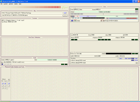

    Here is a snapshot of what one of the files which freezes looks like in GSPOT. Everything looks correct, am I missing something?

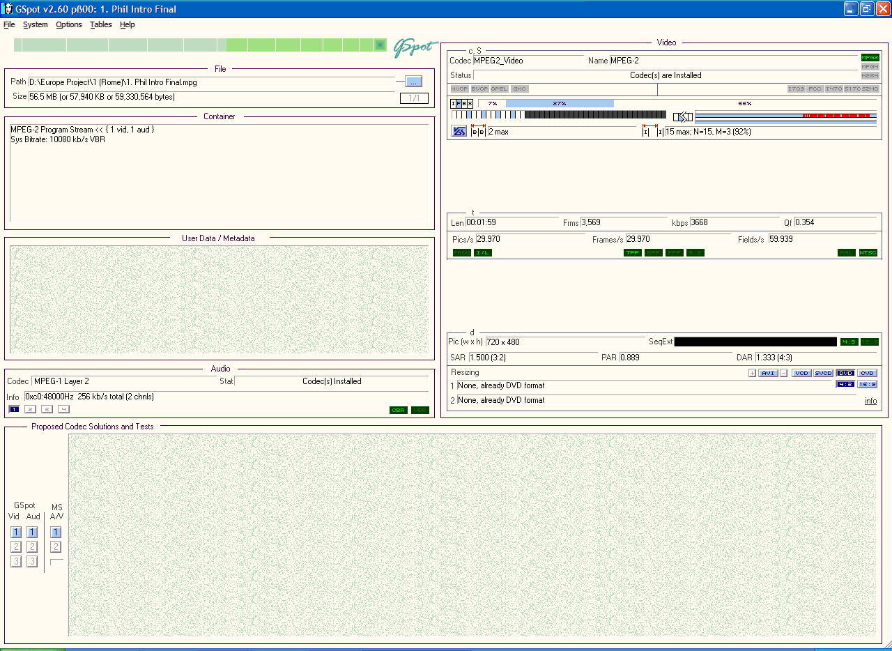

    Aug 2003
    sorry that pic doesn't show up very clearly, I don't know how to post the pic in the message itself. Heres a hopefully clearly pic attached.

    use a bitrate calculator , use 8500 as max anyhow ...
    yes, video would freeze at to high a bit rate
