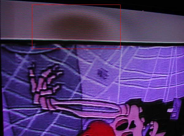

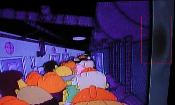

I just purchased an HDTV for the den and while setting it up, I noticed that on some channels during some situations there is a weird area in the screen, especially on channels with grey side panels.
Below are a couple of pictures I took.
Does anyone know what is causing this and what I could to to remedy it?
If there isn't some kind of simple fix or something, I'm just going to take this back to the store.

I agree, I would bring it back and get another.Originally Posted by Denvers DawgsOriginally Posted by lordsmurf

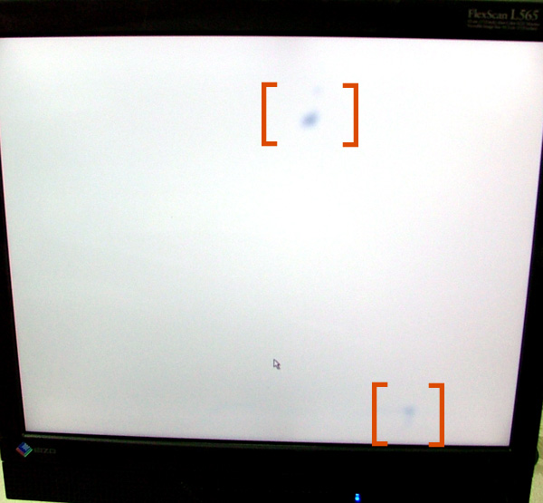

If the blotch doesn't move, I would suspect screen damage also. This is from a site that sells used LCD monitors with occasional defects:
If you can get it to display a blank screen, then you might know for sure. If it does move around, then I don't know what could be causing it.
This was a big (heavy as hell) tube tv. I called Phillips, they said it was damaged. I returned it and wound up purchasing an LCD that was 6 inches smaller (and about 70lbs lighter), works just fine.
Thanks for the help guys.
The only thing I can think of (on a CRT) is a damage/defective shadow mask.
I was thinking the shielding for the built in speakers was damaged or defective, I'm not sure though.
It's not my problem anymore :P
The first Loewe I owned developed strange, urine yellow stains across the screen with a few days of being installed. It would deguass OK on shutdown/startup, but the tsains would return after a few hours. I had it replaced, but the new one developed the same problem. Shielding seemed the obvious answerm but shifting it to a different room away from the speakers etc didn't solve the issue.
In the end, the problem was ferrite in the masks interacting with the magnet field in the area I live. It was replaced with a different model that used a non-ferrite mask, and it hasn't put a foot wrong since.Read my blog here.
