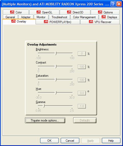

I have no such option in my Overlay tab. Do I need new drivers/software? I'm fairly certain the Windows thinks this is the most recent driver.
rt click desktop, select properties, settings, advanced, overlay, theater mode options...
here's what mine looks like...
