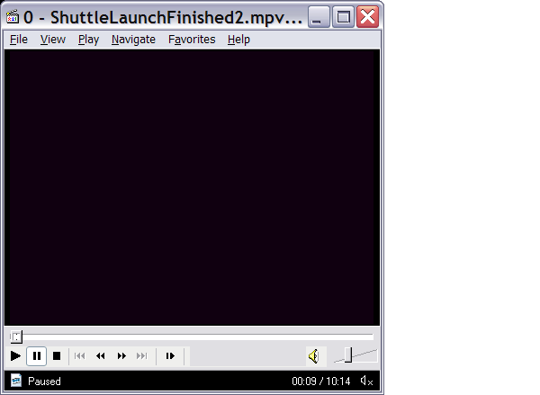

    (Excuse the screenshot, I tried an alt-Print Screen window capture
    of Media Player Classic, but it just comes out black ???)

    Open the file in Media Player Classic and use Save Image As instead
    Read my blog here.

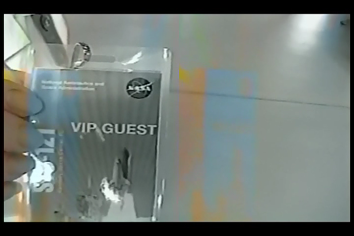

    Thanks for the tip on the Media Player snapshot. Here's a snap of my
    problem video. You can see the red and blue and green colors offset and
    distorted.

  4. Well, the symptom is that the chroma part of the video is being decoded incorrectly.
    If you look carefully, the patterns of color appear twice - once in each half of the screen. They should appear once and stretch across the whole frame.
    This is often caused by a codec error and/or a problem with the next part of the chain not correctly interpreting how the codec encoded the video in the first place.
    The root cause of the error can vary. Video encoded in the YUV color space (as opposed to traditional RGB) can be stored many ways.
    Try the Panasonic DV codec instead of the Cedocida one.
    In the meantime, I'll have a play with the Cedocida codec and see if I can help you track down the cause of the problem.

  5. According to the Cedocida documentation:
    *YV12 chroma sampling
    The YV12 format is a planar YUV color format with 4:2:0 subsampling. The position of the chroma samples differs with the compression standard using it.
    Using the first option (DV), the pixel data is directly feed to or from the the compression algorithm without color shift, interpolation or conversion.
    For (MPEG 2 non interlaced) and (MPEG 2 non interlaced) the data is preprocessed or postprocessed in order to match the given color sampling positions.
    Some remarks on "YV12 (DV)" input/output option in combination with NTSC video:
    Because NTSC DV uses 4:1:1 subsampling type, you will see weird color when viewed with a normal YV12 program which assumes 4:2:0. This is no bug. If you need YV12 format for producing DVD content, use the option "YV12 (MPEG 2 *)".
    That would explain it!

    So it looks like I should be able to configure the Cedocida codec in
    VirtualDub with the YV12 (MPEG 2 *) option when saving the avi prior to
    DVD conversion. I'll give it a shot!
