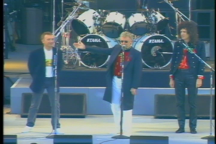

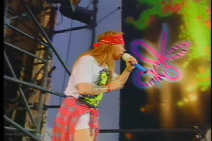

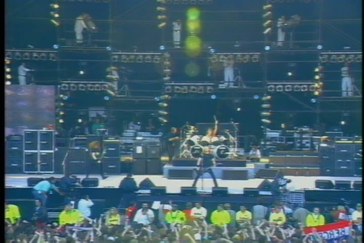

  7. Well, I don't understand why you want me to upload images.
    All this is more of subjective rather than technical nature.
    Even if you say it looks normal - I won't think so
    Ok, I'm sending the images...
    Also, a background. This is a commercially released Freddie Mercury Tribute on LD that I bought few months ago on eBay. I have the worn out VHS myself and since the more recent DVD release didn't feature the entire thing I figured I would get my hands on the best digital (complete) source avaiable - which was the out-of-print LaserDisc. Of course, the problem is that I never owned a LD-player in my entire life so I sent the discs to a guy I know in the States who did this LD>DVD transfer for me. So, now you know what it's all about...
  8. Another one...
  9. And the last one...
    As you can see...especially looking at red, green and even darker areas (that look here more blue-alike), it's a positive sign that the color is too strong.
    Due the digital source, it's not disturbing whatsoever. There is no "color-bleed", only it's a bit higher than usually. The video is pleasant to watch with high bit-rate etc.
    Yet, I would like to lower the colour slightly. What do you think?
