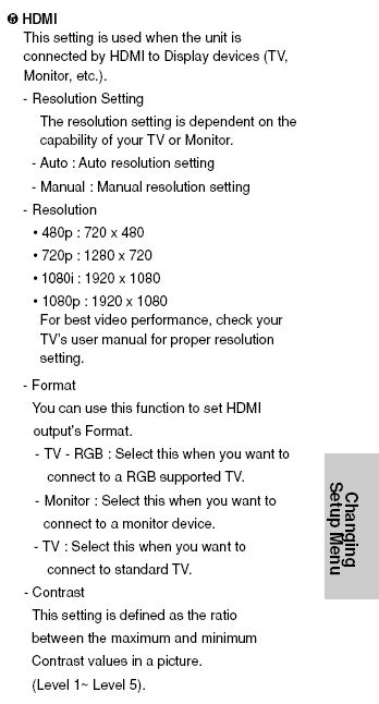

    The DVD_HD960XAA manual has little useful information on 1080p over HDMI as to frame rates. There seems to be a RGB / YPbPr / "monitor"? selection.
    HD-DVD and BluRay DVD also support 1080p (with real 1080p).
