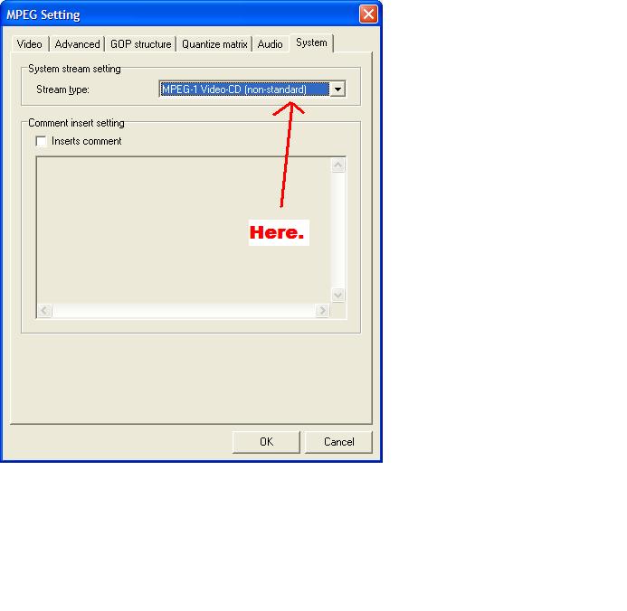

There was an older version of TMPGEnc that would always encode VCD's at the standard 1150 bitrate no matter the setting.
Barring that you should set it to Video CD (non-standard) under the system tab.

It was finally settled a while back, by someone around here who had the Philips White Book documents, that VCD requires a bitrate of 1150 kbps for the video stream. The video itself can be encode with a lower bitrate, but the file should be padded so that it continues to have 1150 kbps overall. All you will be doing is reducing the video quality without reducing the file size or getting a longer running time on CD. So TMPGEnc is behaving properly.
https://forum.videohelp.com/viewtopic.php?p=1531769#1531769
https://forum.videohelp.com/viewtopic.php?p=1535027#1535027
If you want to use a lower bitrate and get smaller files (and hence more running time on a CD) you have to use the "MPEG-1 Video CD (non standard)" setting that ZippyP pointed out. Be aware that some old VCD players will not play those properly. -
