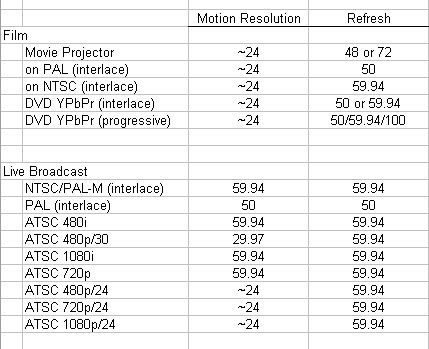

The human eye has several limitations which make movies and TV possible at lower bandwidth. Most of this was well understood by the 1930's and was incorporated into the motion picture and TV system design.
1. The eye-brain sees a limited color spectrum and resolves detail mostly in green-yellow and less in blue-purple-red.
Video consequence
This is the why TV can use Y, R-Y and B-Y components with bandwidth reduction in R-Y and B-Y.
2. The eye-brain is attracted to small motion areas in an otherwise stationary scene but doesn't resolve as much spatial detail in the moving object itself.
Video consequence
This means detail can be reduced in moving objects with nobody noticing (e.g. single field). It also means noise should be reduced in more stationary parts of the image. The eye wants detail in the low motion areas and is distracted by noise.
3. The eye-brain blends sampled motion (~24-90 samples per second) into what seems like continuous motion. Lower range sample rates 24-30 can be used if frames are repeated to 48-90Hz.
Video consequence
Movie houses can use 24fps film by repeating frames 2x to 48Hz. PAL TV repeats to 50Hz. NTSC TV to 59.94Hz.
Film still looks jerky to most people so interlace TV originates with 50 or 59.94 Hz. motion and field refresh. Progressive video has smoothest motion at 50-59.94Hz. with 50-90+Hz. refresh. That is why 720p/59.94 looks best for sports. -

Yes, the eye sees in edges and shapes for moving objects but less internal detail.Originally Posted by Cornucopia
Refresh is best at 75-100Hz but object motion can be lower and still appear continuous.
This approximately how it works for TV.
High end PAL progressive TV sets are now using 100Hz. There is talk of 23.976x3 = 71.93 Hz for NTSC markets. Currently 23.976 alternates 2x 3x to get to 59.94 Hz.
PS: Not so stupid 720p HDTV trick - ABC or FOX could transmit 2 simultaneous 720p/24 movies plus one 480i/29.97 program in the same bandwidth as one 720p/59.94 fps program. The ATSC HDTV tuner is required to do the 3:2 frame repeat to 59.94 fps internally.
