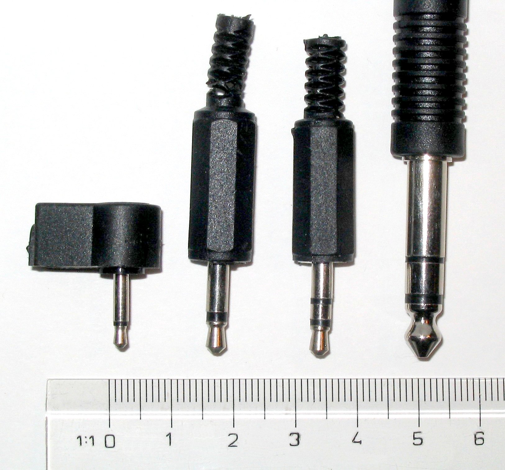

    If you are using a mono (Single channel) microphone and plug, that will just give you one channel, if it even works. The plug won't fit properly. You need to use a stereo type microphone or a 'Y' splitter or combiner with your mono microphone.
    The stereo and mono plugs look like this:

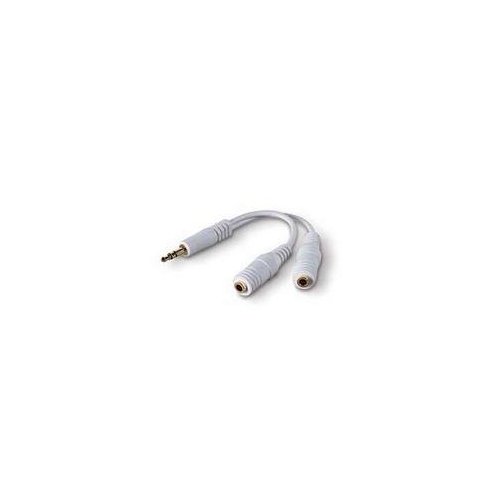

    i tried plugging my mic into the other, and it works but only picks up through one side my left i believe.
    Good deal, Your line input does work with your mono microphone. Use this adapter to get sound from both left and right channels. See : http://www.radioshack.com/product/index.jsp?productId=2102690&cp=&origkw=mono+to+stere...entPage=search
