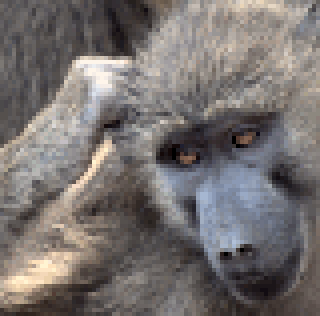

    Think about it. Why is this picture blurry?
    Add to that all the 1/2 motion resolution from dropping a field and encoding artifacts.
    Here is a bit of bilinear upscale filtering with Photoshop.
  5. Hey, that's my monkey!
    Here's part of the original image:
    (a still image from a Sony DSR-PDX10 3CCD camcorder - 1152 x 864)
    If you are dropping a field (the 288 is a giveaway!), you'll get better results keeping the vertical size the same but reducing the horizontal (if you must) - e.g., 256 x 576. Many moons ago - when 100MB hard drives were *the* thing, I would capture to MJPEG at half-width, full-height. It looked a lot better than half-height, full-width since the latter effectively throws out one field. Playing back on a TV, each scan line was effectively duplicated, making the video look very low resolution.
