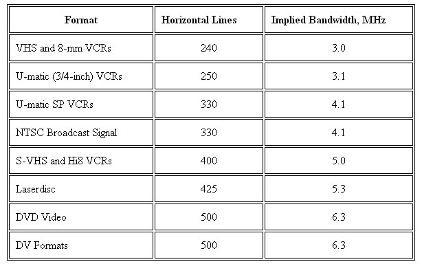

8mm like VHS low pass filters luminance around 3MHz (~240 lines of horizontal resolution). Hi8 like S-VHS uses a comb or notch filter to separate chroma from luminace and record luminance out to near 5 MHz. So yes there is a big difference.

This link is one of the best for technical description of the various analog tape formats.
http://catalogs.infocommiq.com/AVCAT/images/documents/pdfs/TT189%20-%204611.pdf -

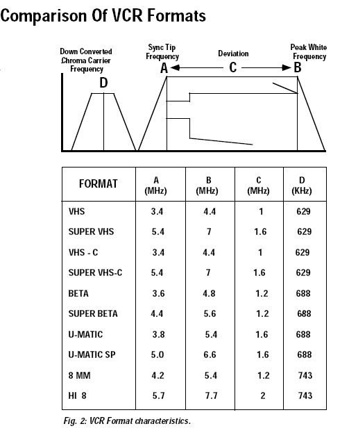

You need to back that up. "Dynamic Range" relates to signal to noise and if anything Hi8 has the edge with wider FM deviation and slightly wider chroma bandwidth. (see below).
Tape issues depend on actual tapes used. Hi8 tended to higher quality MP and ME tape formulations but in a smaller cassette (2hr per MP 120 tape). S-VHS used 1/2" lower quality tape in ~20min VHS-C cassettes.
Both formats had expensive "professional" tape formulations but let's set those aside. Few consumers were buying these $30-60 blank tapes.
In actual use, signal to noise tracked the cost of your camcorder and especially the cost of the tape you were using. Let's call that a wash Hi8 vs. S-VHS.
The major advantage of Hi8 was 2 hr. very good quality recording to a small cassette. The main disadvantage was even small tape defects manifested as large multi pixel dropouts on the playback screen. Sony battled that disadvantage with better tape formulations and digital dropout compensation in the more expensive models. When dropouts were detected, inforrmation from the pervious line was inserted to mask the dropout.
Digital dropout compensation and error correction were developed further for the Digital8 and MiniDV standards allowing even smaller camcorder cassettes.
Ref: http://catalogs.infocommiq.com/AVCAT/images/documents/pdfs/TT189%20-%204611.pdf

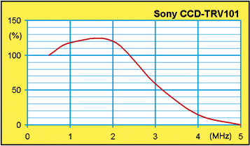

My collection of 1993/4 Hi8 tapes were recorded using a SONY Video Hi8 HandyCam CCD-TR101 (at the time it was the top of the line consumer Sony Hi8 camcorder). Most of the tapes I used were Hi8, but there are a couple of them who are just standard 8. When comparing both I really can't distinguish any quality difference whatsoever which surprises me given the info posted in this thread, basically saying that the quality of standard 8 is about half that of Hi8.Originally Posted by edDV
Originally Posted by alegatorUnless you did the olyteddy trick, it was supposed to use the 8mm format on 8mm tape. There would still be the advantage of the higher end camera section.Originally Posted by olyteddy
Most consumer Hi8 camcorders couldn't get near to 5MHz detail with their single CCD camera sections. That is probably why you saw little difference.
You could get close to full bandwidth from an external high quality source. -
So that means that spending $ in Hi8 tapes was a waste, with standard 8 I was fine...?Originally Posted by edDV
I wouldn't go that far. There should be a difference unless the camera was substandard.Originally Posted by alegator
I found this test report for resolution on Google. If this is true, you would have lost the part over 3MHz and had a bit more noise using 8mm tape.
http://images.google.com/imgres?imgurl=http://www.ev.se/vkam9612/kambild/son_101e.jpg&...ial_s%26sa%3DG
