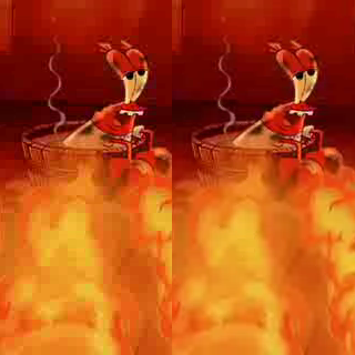

Fod conversion you can try MSU's deblocking filters along with VirtualDub. You'll end up with fuzzy video instead of blocky video. Sample before and after MSU Deblocking:
