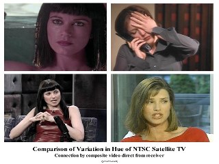

CCEncoder, hello, it's NTSC!! I've had both cable and satellite. The variations in tone have got better over the years but are still present. To give you some idea of how bad it was 5 years ago, attached is a reduced size image showing four of my stations, captured with the same settings within seconds of each other. Not nearly as bad nowadays.
