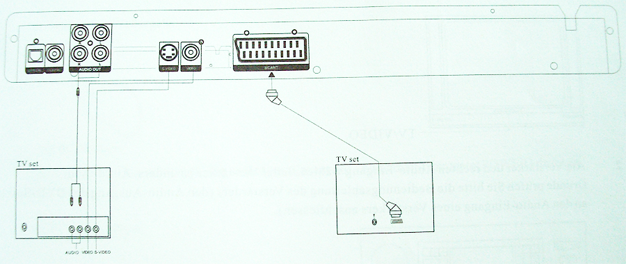

Thanks guns1inger for the precise answer. No my 5.1 does not have a decoder and amp. The Manual is showing diagrams (1 in the pic attached) for output to TV and Audio and stuff but not precisely for 5.1. It has optical and coax out.

From what I see and guess, you would need to purchase a surround sound amplifier. If you have regular speakers (And not computer type 5.1 powered, amplified speakers) you would just hook them up to the amplifier and use either the coaxial or optical audio outputs from the DVD player to get the signal to the amplifier. The amplifier then decodes it to 5.1 and distributes it to the respective speakers. You would have a left and right, and a center, and a rear left and right. That's the 5.1. It may also have an output to a subwoofer for the low frequency sounds.
BTW, coaxial audio is the easiest. You can use a common RCA cable for that with rarely any problems. The optical is good for avoiding noise, but no real difference between the quality of the two most of the time and can cost a fair bit more for the cable. -
