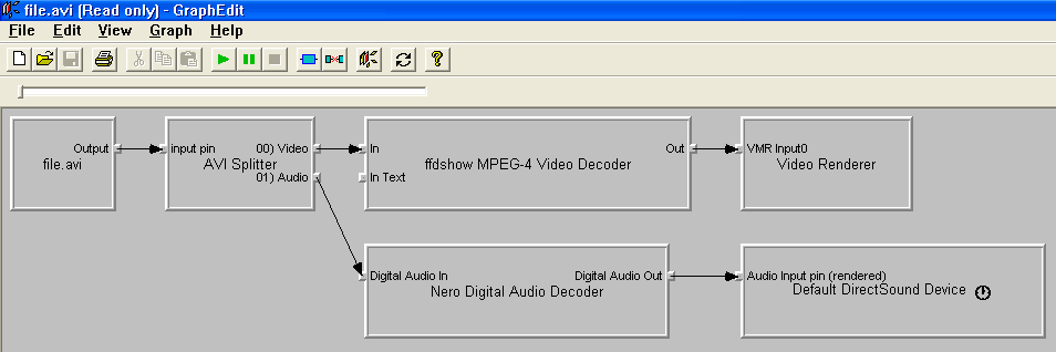

Playing a video with Directshow involves building a filter chain. Each filter performs one function and is connected to the others via a "pin". Each pin may support several different features (different video color depths, audio sampling rates, etc). There is a complex negotiation that happens between output and input pins as Directshow attempts to connect the pins. An example would be something like:Originally Posted by flapperkewiet
The error message you got indicates the program wasn't able to find a filter to handle the output of some of the pins while it was building the graph. So it was unable to get the video all the way from the file to the display.
Installing a codec pack might do something like replace the AVI Splitter with an old version because a certain codec requires it. But maybe that splitter doesnt work with some other codecs you have installed. And uninstalling the codec pack doesn't bother to uninstall that splitter and restore the old one. Now your system is hosed unless you figure out the splitter is bad and how to restore the original one. -
