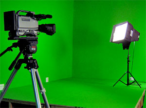

    Example of an insert stage (not mine) where objects or people are shot during post. Just shows how you can operate like the big boys from home.
