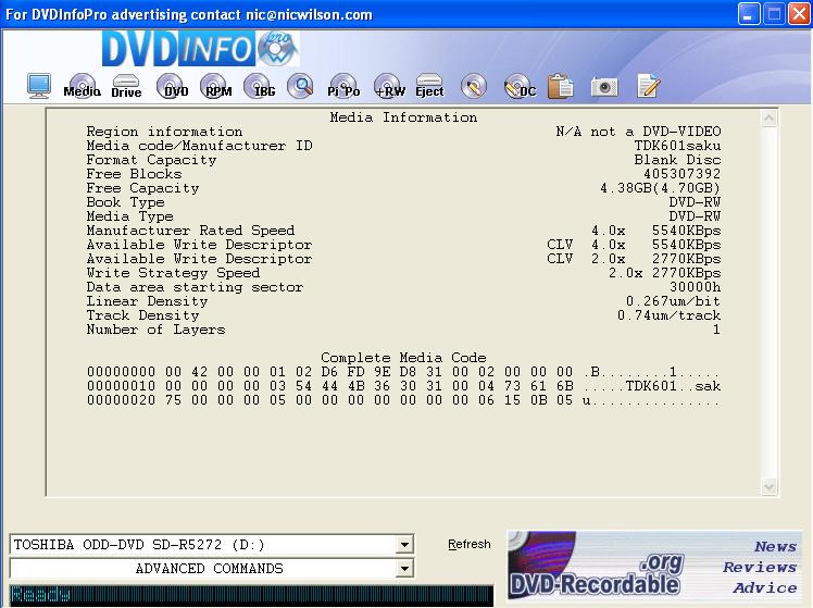

Try downloading freeware DVDInfoPro,
Check your media, it should give a display as below ( this media is a TDK, X4, dvd-rw which was only formatted on a Panasonic ES35V ),
If that works, click on the disk icon just to the right at the top. It should give you the following screen,

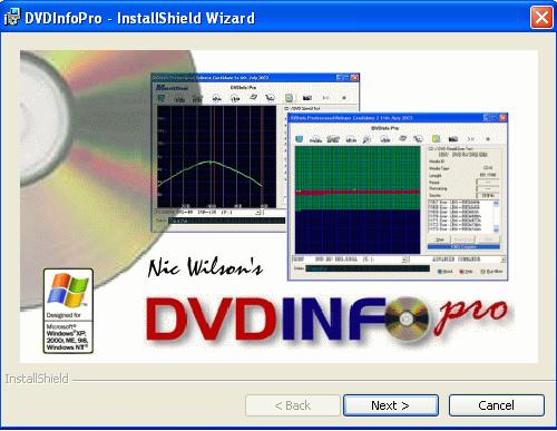

The downloaded file should be a zip file and should show up in your computer like this,
clicking on the file should give you,
then clicking on the DVDInfoPro icon should lead you to this screen,
msi files are like executable zip files. I believe they are supported by Net Framework.
