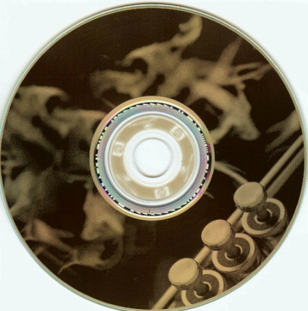

    I'll post a pic of what I've gotten with a random LiteOn Drive using HP media. Its a scanned image so at its normal resolution that u'll see if it shows as a clip (reduced size) it should be like what I printed, if you zoom in, the scanner isn't so good (times like these I wish I had a digital camera).
    Burned this once using the contrast utility and some random drive, and to be honest, I thought it was better than the picture template at Lightscribe.com.

    That's a really nice cover! I don't have any photos right now, but I made one for a friend which had a photo of his 4 daughters on it. It was really beautiful. I've read that HP is working on making a color lightscribe. Then we'll be in hog heaven. I've made lots of covers now with photos on them. It takes a while to write, but hey, we do other things in our lives that take 20 minutes to a half hour. Breaks, dinner, sleep. Here's one from lightscribe's gallery. I don't particularly like this one "ok, now look manic" but it shows the possibilities.
