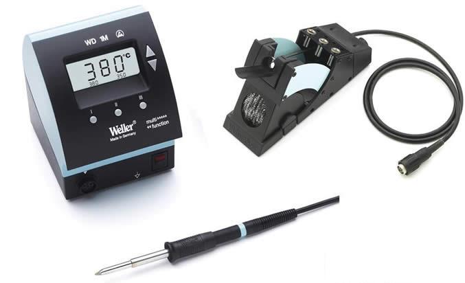

    Ok I wanted to revist this. At the time I bought the replacement bulb on ebay. It looked like the one in the projector however the connector leads did not fit.
    Is it possible to snip those off and solder on the correct leads from the bulb that does fit? I'd only do that once the working bulb actually fails.

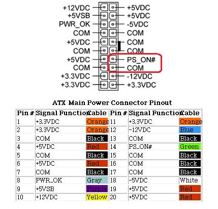

    Another question - I know have a spare computer power supply since upgrading my vista pc to a 650 watt psu. This is a 300watt psu that I have spare. IS THERE A WAY TO UTILIZE THIS FOR A DO IT YOURSELF PROJECT?

    If you feel confident about soldering the leads to the new bulb/holder it might be worth a try. I'm assuming you can't exchange/return the bulb. Be careful around that bulb. If it shatters you could get injured or make quite a mess with small glass shards. And never touch the glass surface of the bulb. If you do, wipe it down with alcohol to remove the finger oils or it will fail quickly.
    Not sure about your power supply question, it depends on what you want to use it for. You can jumper the 'ON' terminal to a 'Common' terminal and activate the PS, but it may need a load on certain rails to regulate properly, so not really a good choice for just using the different voltages in other applications.

    @redwudz - thanks. Yeah i bought the replacement on ebay about the time I started the thread. I tried getting in touch with the seller but no go. That's ok - I generally treat anything I buy on ebay as "throw away" money in the event it doesn't work or I dont' get it.
    I think i might give the soldering a try when the working bulb goes. Though I've never really soldered so wh knows.....
  22. Mod Neophyte redwudz's Avatar
    USA
    Probably for what you have a mind, a visit to a local Radio Shack store will likely get you what is needed. If the wires are fairly large, then a soldering gun, maybe 100W may be needed. For most wires such as the size a computer has, a 40W soldering iron would be large enough. I use a 15- 25W for PC boards. A short soldering guide: http://www.elexp.com/t_solder.htm A little practice before you tackle the 'real' job is also advised.

    question: how hot do these bulbs get?? is it possible they get hot enough that your solder will melt?...
    I am just a worthless liar,
    I am just an imbecil
  24. The melting point of solder is 400 °C (800 °F).
    Off by a factor of 2. Typical lead/tin solder melts in the neighborhood of 200°C - which is ~400°F, maybe that's what you meant?
  26. Mod Neophyte redwudz's Avatar
    USA
    You won't find much tin/lead solder anymore. It was replaced with a tin/silver based solder, which, IMO, doesn't work as well. It has a slightly higher melting point, but still around 400 - 470F, depending on the tin/silver mixture.
    The part of the bulb housing with the connectors won't get anywhere near that hot, at least with my projectors. But I wouldn't want to solder anything directly to the bulb. That may use a much higher temperature solder.
    Right, of course. I shoulda known that, since we switched all our assembly processes to lead-free a couple of years ago.
    Must of been all the lead fumes I inhaled early in my career

  30. Originally Posted by SingSing
    I mean what you should set the soldering to :
