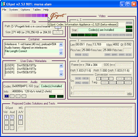

I tried to convert a DVD into AVI because I need to insert some clips into a new video using Première Pro. I tried using several different conversion programs, but the results were very poor. The only one who gave me a good result was FAIRUSE WIZARD (I found this suggestion in this Forum). But when I import the converted .avi file in the storyboard of Première, I don't see the video (while the audio is ok), just a black frame. Any suggestion?
Thanks in advance
P.S.: I tried to open the converted .avi file using Windows Media Player, and it works perfectly.

You have the correct codecs, however I don't believe Premiere likes importing or working with Divx encoded files. Which version of Premiere are you using ?
You might be better off loading the file into virtualdub, and saving it out as losslessly compressed lagarith or huffyuv (note : you may have to install one of these)Read my blog here.
