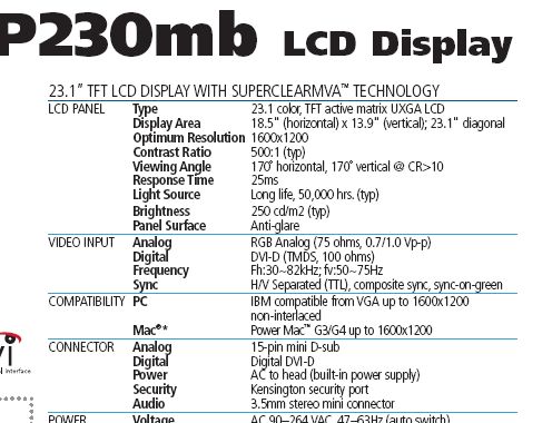

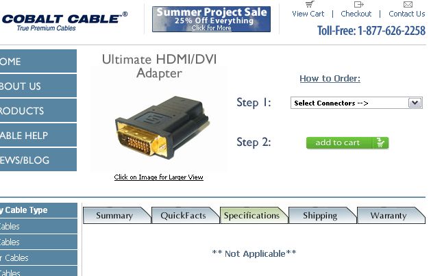

I found this website that offers HDMI-to-DVI adapters to be able to use a DVI PC monitor as a playback HDTV for HD camcorders with HDMI output. I have a DVI Viewsonic VP230mb 1600x1200 LCD display that I would love to use it for this purpose (I don't have a HDTV tv set). My questions are:
- The site claims quality is not downgraded in going from HDMI to DVI, but at the same time one is bypassing the video card as it is a directo connection between the HC3 and the monitor. Would I actually see the display quality as I do when playing a HD video in WinXP with WMP?
- Do these adaptors actually work? Anyone has the experience doing this? And what about audio? How can I output audio from the HC3? (the DVI only carries video signal, not audio)
- How can I find out if the HC3 HDMI is compatible with the Viewsonic VP230mb? (I read many people had trouble with the HC3 HDMI output to various HDTV models).
Thanks for any answer.
http://www.cobaltcable.com/hdmi_dvi_adapter.htm

The Viewsonic VP230mb is a computer monitor that accepts normal computer VESA resolutions over DVI-D. Native resolution is 1600x1200 RGB.
Sorta like French and Chinese unless you find 1080i support through the Viewsonic site.
As for Cobalt cable, they only offer a connector pin reassignment HDMI to DVI-D.
If they are offering claims, it isn't in the specs.
You are on a blind alley. I bet they sell a ton of these to people expecting a 1080i connection to a computer monitor. -

Don't expect to connect a HDTV source to a computer monitor without an expensive format converter inbetween. That is unless the monitor spec says 480i, 480p, 720p, 1080i or 1080p are supported. -
