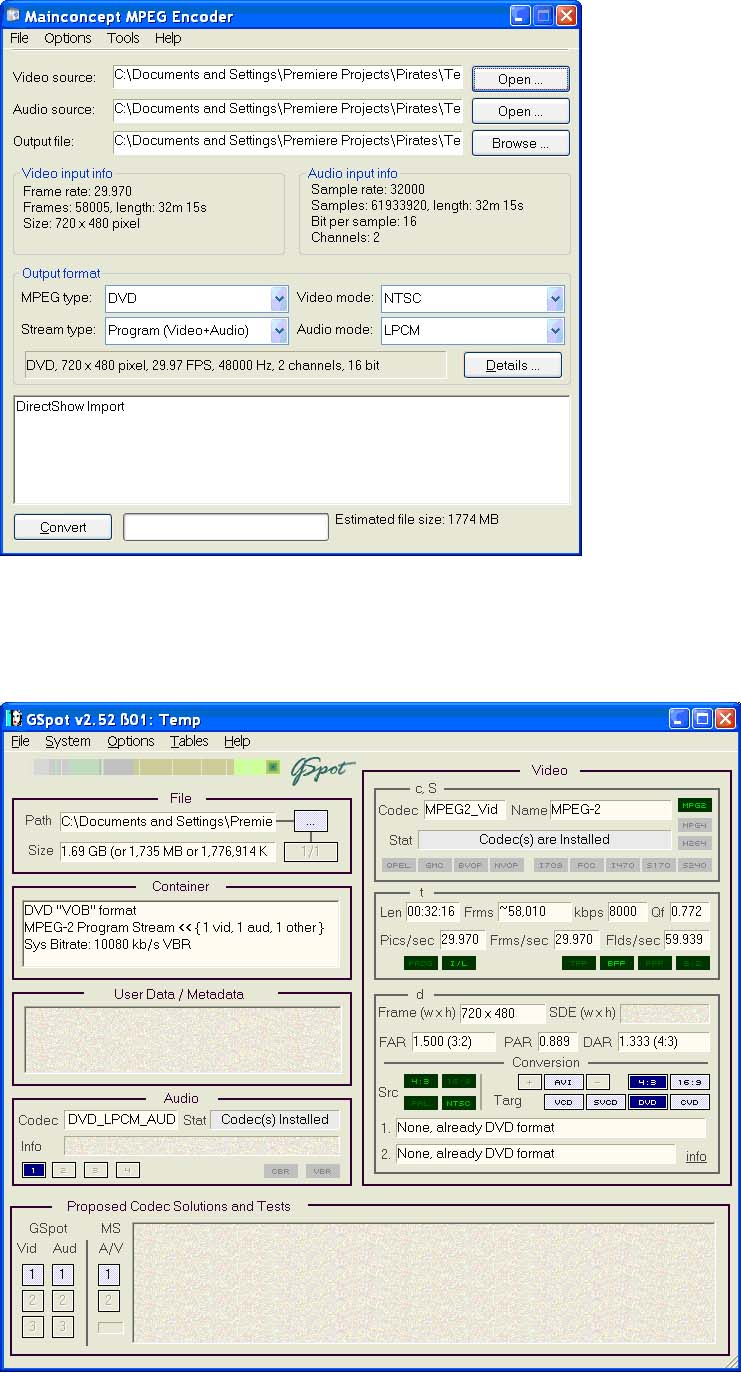

    Thanks for the help so far. I have downloaded the trial version of MainConcepts MPEG Encoder 1.5. I also found that I had the Premiere plug in version 1.1. First I tried to convert the AVI file of a timeline that I exported in Premiere using MPEG Encoder 1.5. When I opened the “Video Source” file I accepted all of the output settings that MPEG Encoder suggested. I then took the MPG file created by MPEG Encoder and used Movie Factory 2SE to make a DVD, making sure that I changed the “Resample Quality” to best (the highest setting) as well as making sure that “Do not convert Compliant MPEG Files” was selected. The resulting DVD looked like it may be slightly better in picture quality but it is almost unnoticeable. I have yet to play with the Premiere plug in version 1.1 to see if I get better results.
    Below are two screen prints. One of the settings I used to convert my AVI to MPG using MPEG Encoder & the other is a screen print from G Spot of my converted MPG file
    Can anyone tell me what settings I should use to convert the highest quality picture from my AVI file using MPEG Encoder?

    On first look all is in order
    720x480, 8000Kb/s video LPCM 48KHz. audio
    Did it come out 16:9 as planned? No, I see 4:3 in G-Spot. Aspect ratio and bitrates are set under that "Details" button.
    I'm still uncomfortable using Movie Factory 2SE which is older than the hills. Current version is v5 and it also comes with a version of the Mainconcept MPeg2 encoder.

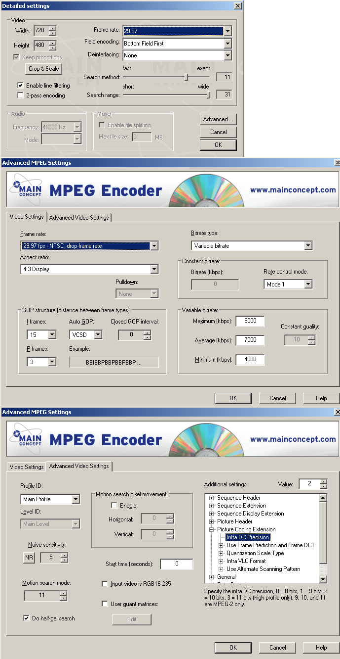

    I'm responding to your post because I like the name Cobra Jet. It reminds me of my old 67 Mustang Fastback that had a 428 Cobra Jet. That car was real cool and very quick! One of my favorate cars Ive owned through the years.
    Anyways, back to your questions. MainConcept is a great encoder when you use the correct settings, but you need to learn them. Here is some old settings I used to use for 30i (you'll have to change the AR to 16:9 and used 2-passes for VBR or 1-pass CBR):

    Dipstick, Thanks for the info. I use the settings you suggested with MPEG Encoder and I was pleased with the results. I do have one more question. I did my conversion using 2-pass VBR but I was wondering what reasons I would use VBR verses CBR.
