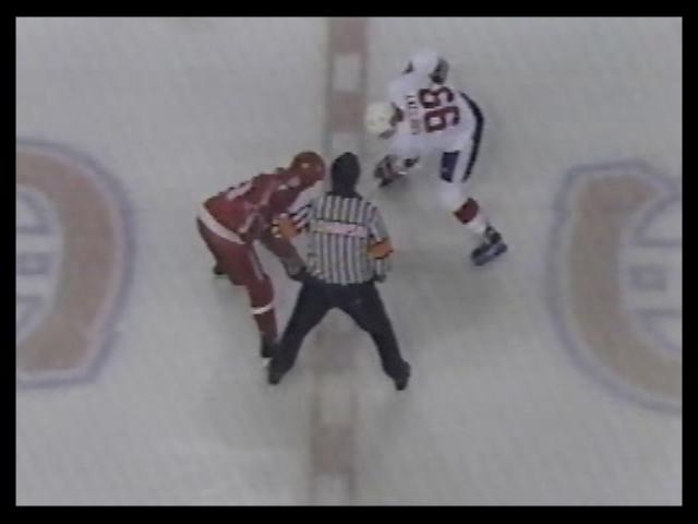

That looks more like herringbone than chroma, but being the colors they are, hard to tell from that image. You may want to troubleshoot power cleaning and grounding options for that, just in case it's actually herringbone.
