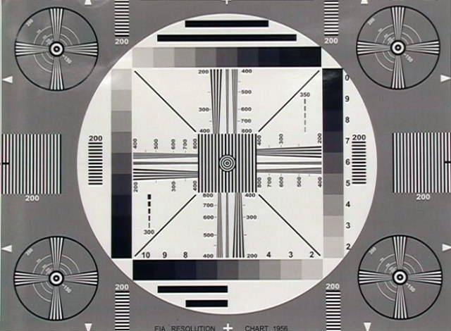

    There is vertical resolution limited by the number of scan lines with perceived resolution limited further by the Kell factor (see ref above). 480i vertical resolution is locked in to around 330 unless you do something silly like tossing every other field. But you need 480 scanned lines to achieve 330 "lines of perceived resolution" as read from a chart.
    4:3 and 16:9 aspect ratios demand more raw resolution in the horizontal direction. "Lines of resolution" is read from a test chart that references a central circle where horizontal and vertical resolution are measured by the eyeball the same way regardless of aspect ratio.
    Horizontal resolution is where the action is. It is limited first by recording format and next by the capture camera lens, CCD sensor and video processing performance. If you buy a cheap Hi8 camcorder the camera may only deliver 200 lines of horizontal resolution even though the recording format can handle 400-440 lines. You need to determine how good or crappy your camcorder performs but purchase price and year bought are good indicators. Everything gets better and cheaper over time.
    A good consumer Hi8 camcorder like my 1990 Sony CCD-V5000 ($3000 at the time) will get close to those 440 lines limited mostly by inherent noise in the Hi8 recording format. The same camcorder performs much better when recorded to DV format over S-Video. At that level of performance, there is no benefit of 720x480 over 640x480 but DVD doesn't give you the choice. The choice is 352x480 (too low) or 704x480 or 720x480.
    440 lines of horizontal resolution does not mean 440 pixels. The chart is measuring distinction of alternate black and white lines. You need more pixels (~1.4x or more) to resolve alternate lines. The wider the aspect ratio, the more horizontal pixels you need for the same performance. 4:3 Hi8 maxes around 640x480. DV and DVD use 720x480 for either 4:3 or 16:9. At 4:3 aspect ratio, 720x480 is good for about 500-550 "horizontal lines of resolution".
    If you want the optimal Hi8 tape transfer, you bite the bitrate bullet and archive at 704 or 720x480 @ 7000 Kb/s or more average bitrate. The more shakey the camerawork, the less interframe compression you will get so dial in more bitrate.
    EIA resolution test chart. This is put in front of the camera lens and read off a good monitor.
